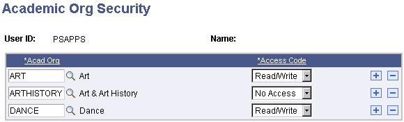

Access the Academic Org Security page (Set Up SACR > Security > Secure Student Administration > User ID > Academic Org Security > Academic Org Security).
Image: Academic Org Security page
This example illustrates the fields and controls on the Academic Org Security page. You can find definitions for the fields and controls later on this page.
Enter the highest academic organization in the hierarchy that the user ID should be able to access. Insert rows to add academic organizations or to restrict access to a particular academic organization lower in the hierarchy.
Academic organization security is based on the hierarchy in the academic organization security tree. The academic organization that you identify here must be a node on the academic organization security tree. Granting access to one node of the academic organization tree also provides access to all child nodes for that organization. To restrict access to a child node, select the academic organization that you want to secure and set the access code to No Access.

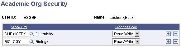

Example 1
This security setup grants the user ID access to all academic organizations under the Biology and the Chemistry nodes in the security tree:
Image: Permission for specific academic organizations (SCRTY_TABL_ACAD)
This example illustrates the fields and controls on the Permission for specific academic organizations (SCRTY_TABL_ACAD). You can find definitions for the fields and controls later on this page.

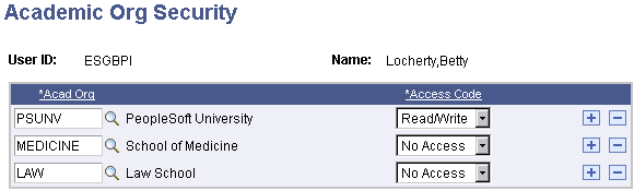

Example 2
This security setup grants this user ID access to all academic organizations under the PeopleSoft University node except any that fall under the School of Medicine or Law School node:
Image: Permission with restrictions for academic organizations (SCRTY_TABL_ACAD)
This example illustrates the fields and controls on the Permission with restrictions for academic organizations (SCRTY_TABL_ACAD). You can find definitions for the fields and controls later on this page.
The School of Medicine and Law School are excluded because the access code is set to No Access.
