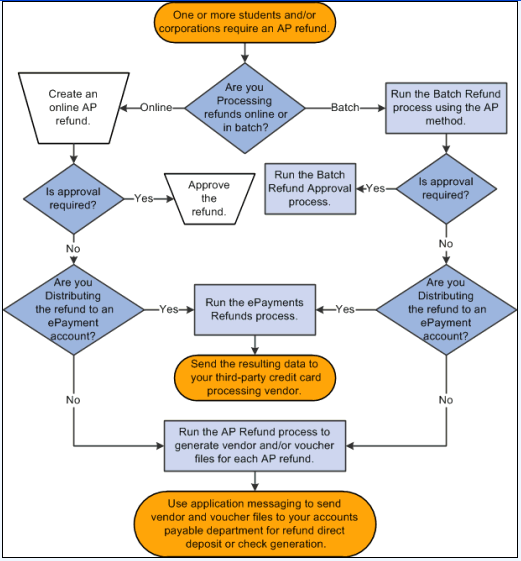

The following diagram displays the decisions and processes involved when creating and distributing AP refunds.
Image: AP refund process flow
AP (Accounts Payable) refund process flow
