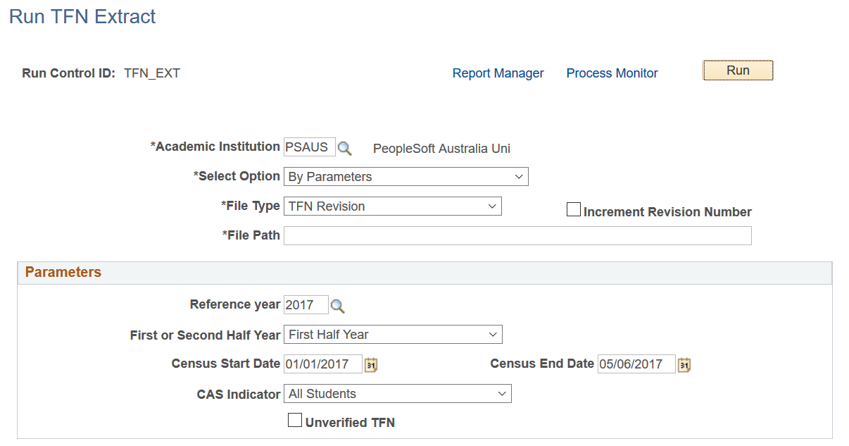

Use this page to extract student Tax File Number (TFN) data using parameters, population selection or by students, to verify student TFN information before submitting periodic report data. This process does not populate the work tables.
Access the Run TFN Extract page ().
Image: Run TFN Extract page
Extract student TFN data using parameters, population selection or student IDs.
Field or Control |
Definition |
| Select Option |
Select an option by which to extract the TFN data—parameters, population selection, or student ID. Based on the selected option, the system prompts you for further details.
| File Type |
Select whether to generate a TFN Revision (TR) or TFN Lookup (TL) file. |
| File Path |
Enter a location to save the generated TFN file. |
| Increment Revision Number |
Select to increment the Revisions Submission Number on the Reporting Setup page after the process completes successfully. |
| Unverified TFN |
Select the check box to extract information only for unverified TFN numbers. |
