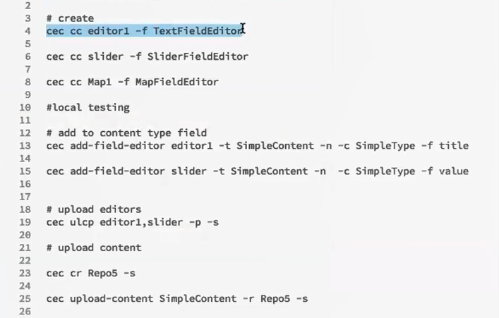

Для разработки пользовательских редакторов полей доступны следующие команды инструментария OCE:
cec add-field-editor <name> Adds a field editor to a field in a content type. [alias: afe] cec remove-field-editor <name> Removes a field editor from a field in a content type. [alias: rfe] ------------------------ cec add-field-editor ------------------------ Usage: cec add-field-editor <name> Adds a field editor to a field in a content type. Options: --template, -t The template the content type is from [required] --contenttype, -c The content type [required] --field, -f The field the field editor is for [required] --contenttemplate, -n Flag to indicate the template is a content template --help, -h Show help [boolean] Examples: cec add-field-editor editor1 -t BlogTemplate -c BlogPost -f summary Use editor1 as the appearance for field summary in content type BlogPost from local template at src/templates/BlogTemplate cec add-field-editor editor1 -t BlogTemplateContent -n -c BlogPost -f summary Use editor1 as the appearance for field summary in content type BlogPost from local template at src/content/BlogTemplateContent ------------------------ cec remove-field-editor ------------------------ Usage: cec remove-field-editor <name> Removes a field editor from a field in a content type. Options: --template, -t The template the content type is from [required] --contenttype, -c The content type [required] --field, -f The field the field editor is for [required] --contenttemplate, -n Flag to indicate the template is a content template --help, -h Show help [boolean] Examples: cec remove-field-editor editor1 -t BlogTemplate -c BlogPost -f summary Remove editor1 as the appearance for field summary in content type BlogPost from local template at src/templates/BlogTemplate cec remove-field-editor editor1 -t BlogTemplateContent -n -c BlogPost -f summary Remove editor1 as the appearance for field summary in content type BlogPost from local template at src/content/BlogTemplateContent

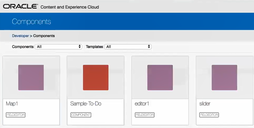

TextFieldEditorSliderFieldEditorMapFieldEditorНа рисунке ниже показаны команды инструментария OCE, которые можно использовать для разработки образцов компонентов внешнего вида поля.
Можно создать на локальном сервере компоненты внешнего вида поля, протестировать их и загрузить в экземпляр Oracle Content Management. На рисунке ниже показаны эти компоненты в узле localhost:8085.

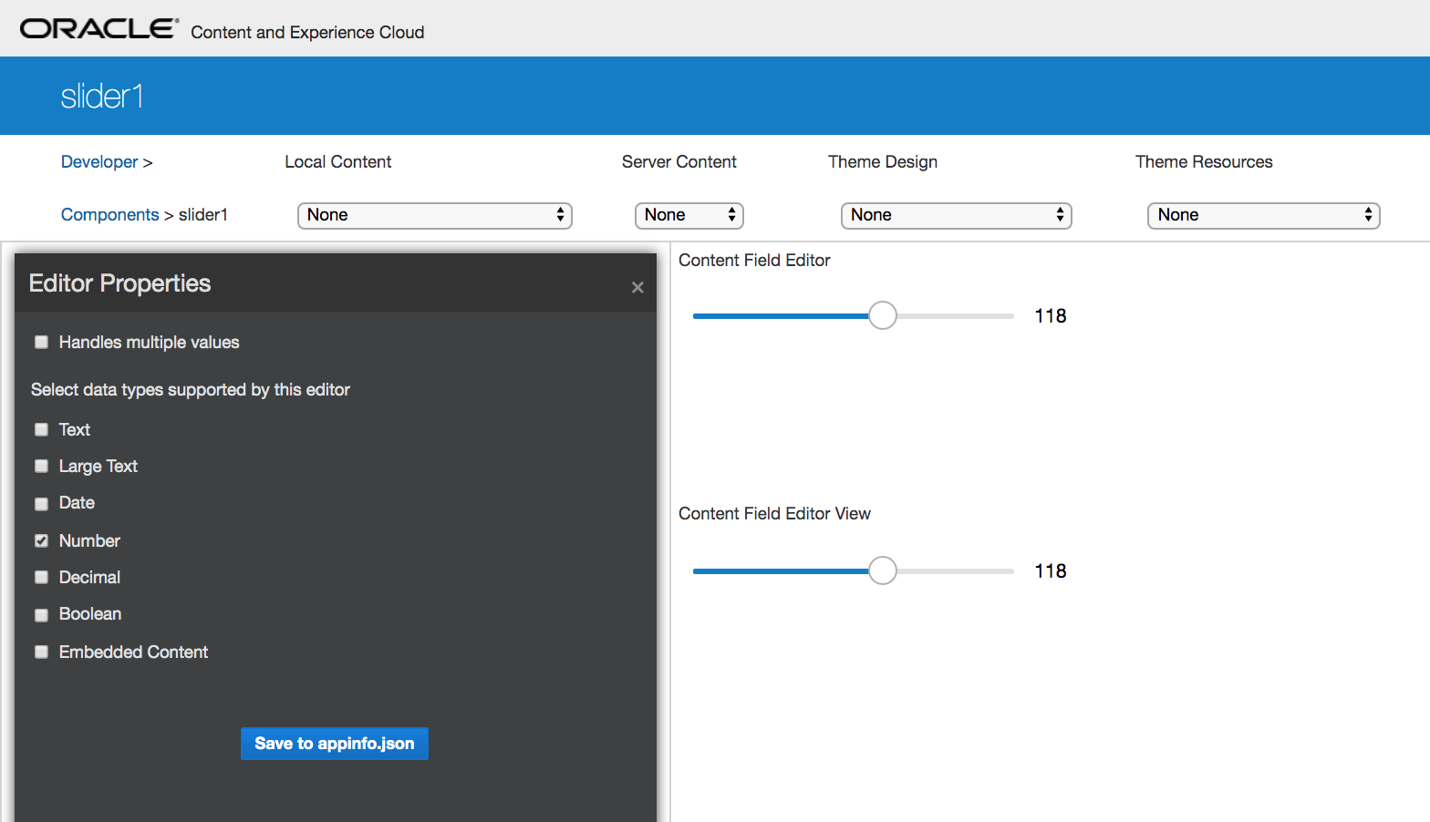

На локальном сервере можно протестировать любой компонент, например ползунок. Здесь можно выбрать свойства компонента и сохранить его.

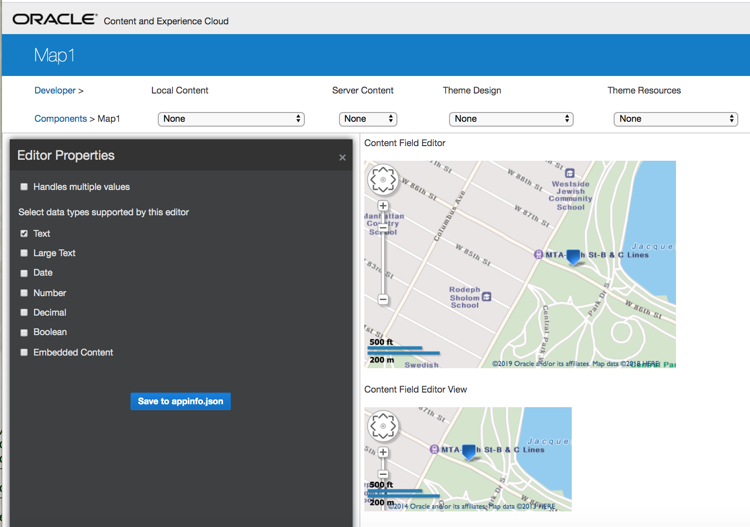

В случае компонента карты можно нажать на карту, чтобы указать местоположение в качестве значения редактора.

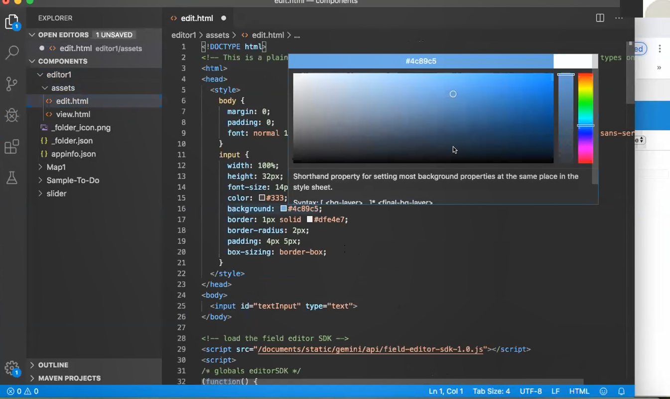

Можно отредактировать HTML-файл компонента, чтобы изменить его настройки, такие как цвет фона.
С помощью команды инструментария OCE можно локально связать редактор полей с полем типа контента:
cec add-field-editor editor1 -t SimpleContent -n -c SimpleType -f title cec add-field-editor slider -t SimpleContent -n -c SimpleType -f value

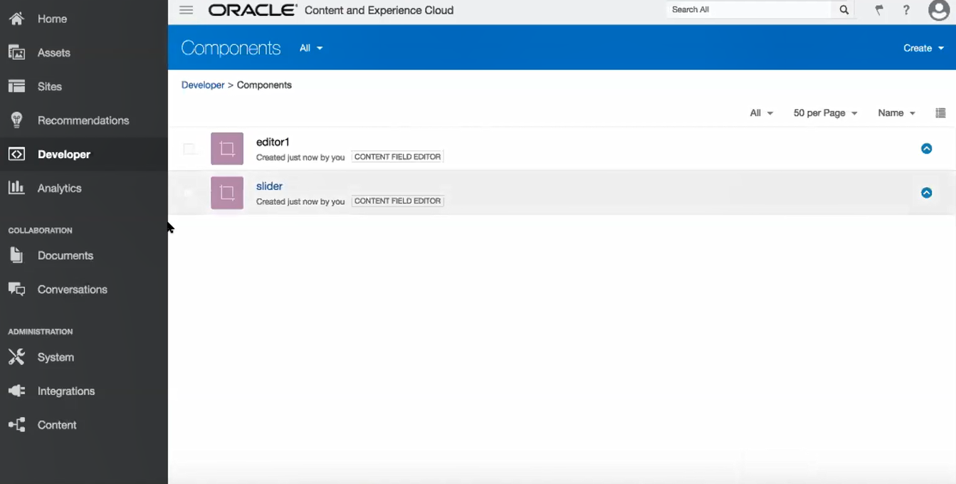

После завершения настройки и тестирования пользовательские редакторы полей можно загрузить в экземпляр Oracle Content Management с помощью команд инструментария OCE:
# upload editors cec ulcp editor1,slider -p -s Latest # upload content cec cr Repo5 -s cec upload-content SimpleContent -r Rpo5 -s
При загрузке пользовательских редакторов полей компоненты импортируются в экземпляр Oracle Content Management.
