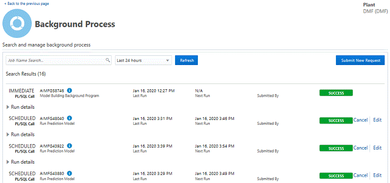

You can select to schedule the programs to run at a scheduled time, repeating at a certain interval, or immediately. You can use the Background Process page to search for and manage background processes or submit a new request.
Important: Only users with the Application Administrator role can submit a new request.
Navigate to the Background Process page.
From the User Name drop-down list, select Background Process.
The Background Processes page appears with the list of programs that have been scheduled and run.
You can use the Job Name Search field to enter and search for a specific job for which a program has been run in the last 24 hours or last 7 days.
Click Refresh.
Use the Background Processes page to view the following information for each background process:
Immediate or scheduled type of run
Job Name
Program name
Date and time of last run
Date and time of next run
Optional Action: If the job has a scheduled next run, you can click Cancel to cancel the scheduled job or Edit to change the repeat interval, start date, or end date.
Submitted By
Status of run

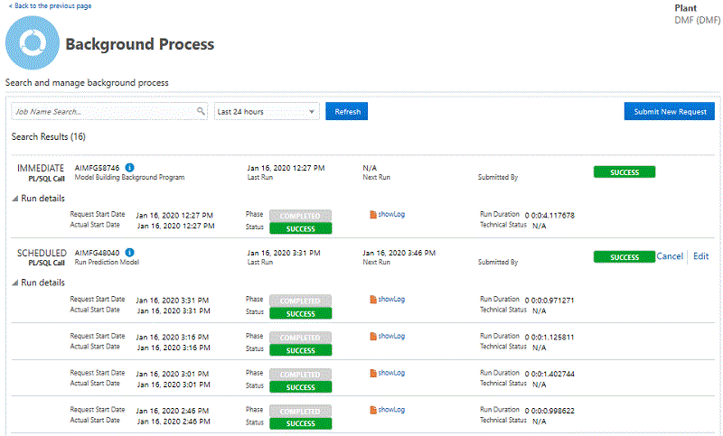

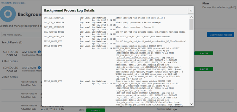

Click Run details to view:
Request Start Date
Actual Start Date
Phase
Log details
Run Duration
Technical Status
Click showLog to view Background Process Log Details.

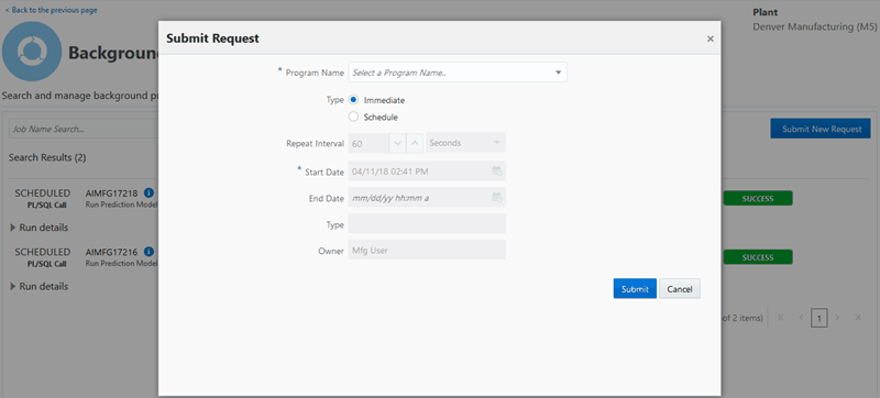

In the Background Process page, click Submit New Request.

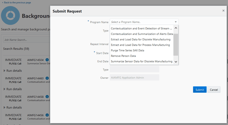

In the Submit Request page, select a program from the Program Name list.
Select Type as:

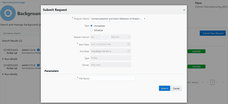

Immediate to run the program immediately.
Schedule to run the program at a later date and time.
If you select Immediate, enter the parameters listed for the program you are running, and then click Submit to run the program.

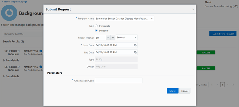

If you select Schedule, enter details for the following:
Repeat Interval
Start Date
End Date
Enter the parameters listed for the program you are running.
Click Submit to schedule this request.
The following table lists the background processes you can run in Adaptive Intelligent Apps for Manufacturing:
| Program | Description |
| Contextualization and Event Detection of Stream Data | Contextualizes stream data for an uploaded stream data file, with equipment context, work context and serial context, and derives the event from the stream data according to the setup of the machine event analysis feature set. Enter the following parameter before submitting the program to run: File Name. |
| Contextualization and Summarization of Alerts Data | Contextualizes event/alert data for an uploaded alert data file with equipment context, work context, and serial context and summarizes the continual event/alert records with start and end time. Enter the following parameter before submitting the program to run: File Name. |
| Extract and Load Data for Discrete Manufacturing | Retrieves the most recently loaded quality data for discrete manufacturing organizations from the data lake in the Oracle Cloud. Enter the following parameter before submitting the program to run:
| Extract and Load Data for Process Manufacturing | Retrieves the most recently loaded quality data for process manufacturing organizations from the data lake in the Oracle Cloud. Enter the following parameter before submitting the program to run:
| Maintain Multi-lingual Tables | Refreshes the translation of the translatable data ingested into AIAMFG. Run this process on an as-needed basis. |
| Purge Time Series SAX Data | Purges time series SAX data for a specified time period for a dataset. Enter the following parameters before submitting the program to run:
| Remove Person Data | Obfuscates the user name and display name of a user created in Oracle Identity Cloud Service (IDCS) as well as a person identified when ingesting business entity or case record data. Enter the following parameters before submitting the program to run:
Important: This background process removes the person data from AIAMFG. You must remove the user from IDCS separately. See: Removing Users from Oracle Applications. |
| Summarize Sensor Data for Discrete Manufacturing | Extracts the time series features for running predictions model and summarizes sensor data for discrete manufacturing organizations. Enter the following parameter before submitting the program to run: Organization Code. |
| Summarize Sensor Data for Process Manufacturing | Extracts the time series features for running predictions model and summarizes sensor data for process manufacturing organizations. Enter the following parameter before submitting the program to run: Organization Code. |
| Update Actuals for Prediction Model Targets | Extracts the actual values of the targets of the completed work orders for use in the confusion matrix. |
