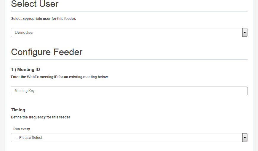

  3. Double-click the element to open the configure screen. The window that opens enables you to do the following:
    • Change the name of the step to something more meaningful
    • Configure the element
  4. Click the Edit icon to configure the action.
    An image of the WebEx Meeting/Event Register Feeder Configuration window.
    The configuration screen provides the following options:
    1. Select User: Select a WebEx user for this service. Administrators with appropriate permissions can add and modify WebEx users by re-configuring the app.
    2. Meeting ID: Enter the WebEx ID for an existing meeting or event.
      Note: You may wish to copy the ID for future reference so that you can easily refer to it.
    3. Timing:
      • Run Every: Select the frequency for the feeder (from 15 minutes up to 1 day).
      • Until: Select the end date.
  5. Click Save.
  6. Test your configuration.
When WebEx registrants flow through the audience element, they are added to Oracle Eloqua as contacts at the regularly scheduled intervals.
