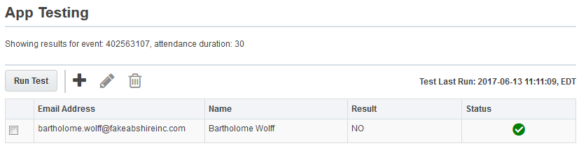

Click the test icon .
Click the add icon to select up to 10 contacts. You can search by email address or name. Replace a contact by selecting the check box and clicking the edit icon . Remove one or more contacts by selecting the check boxes and clicking the delete icon . Undo any changes you've made by clicking the Undo icon . All test data is erased when contacts are replaced or deleted.
Click Run Test.
The test displays the following results for each contact:
Result: The result of the operation.
Status: The test status for each contact. A detailed error message is displayed if the test did not complete or if the contact was not found.
