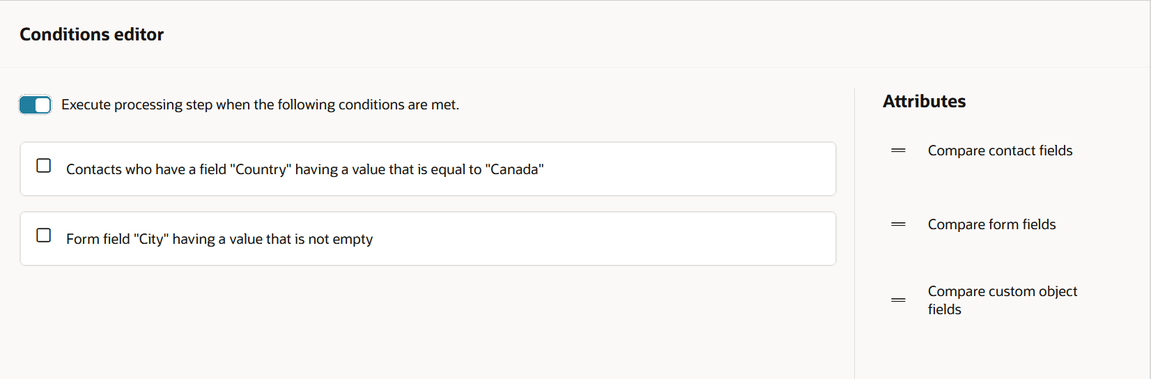

You can configure the step to occur only when certain conditions are met. For example, you could use a condition to subscribe a contact to a mailing list if they selected the applicable option in the form. You can create conditions that evaluate against the following data:
  • Contact fields
  • Custom objects
  • Form fields
If you add multiple conditions to a form processing step, they are joined together using a Boolean AND operator. This means that all of the conditions must be met in order to run the processing step. In the following example, two conditions have been set up for the Send Submitter an Email processing step. The first condition ensures the submitter opts in to receive the newsletter, and the second condition ensures that the submitter is in the correct region.

  3. In the Conditions Editor, click the type of information you want to evaluate against in the drop-down list. You can use contact fields, custom objects, or form fields.
  4. Double-click the field that you want to test against in the condition.
  5. In the right pane, double-click the field you added and configure the condition. Consider the following when configuring the condition:
    • You can configure the condition to match exactly what you specify or not.
    • You can compare to a form field value or a value you provide.
  6. Click Close and save your changes.
After you close the window, a small badge appears indicating the number of conditions. Hover over the icon to quickly view the configured conditions.
