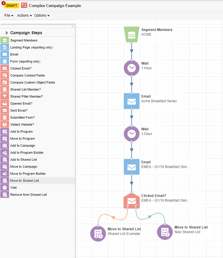

There are many campaign steps available to you when creating a campaign. This tutorial outlines how to use the application API to create a campaign with campaign steps and provides an example. After you understand how to create campaign, see campaign element reference for a full list of all campaign steps.
Creating a campaign with steps
Creating a campaign with steps is done using the elements array. Here is an example of a campaign in Eloqua.
The following request outlines how to create this campaign using the API. Note the elements .
