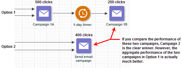

- Regardless of the selection mode, take a look at the results of your test to make sure you are measuring the right things. For example, the following illustration shows how the path with the best performing campaign is not necessarily the overall winner.

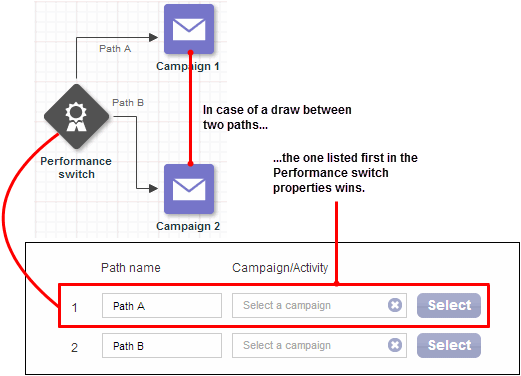

- If your performance switch is set to automatic selection and two or more campaigns yield the same performance, the path listed first in the performance switch properties is declared the winner.
