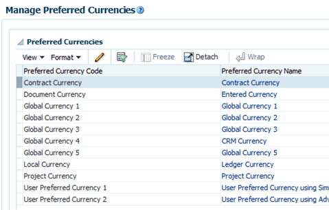

- Select the Manage Preferred Currencies link in the System Setups area on the Tasks bar.
- Select a currency in the Preferred Currencies list. Selecting the currency displays the associated modules in the bottom table.
- Click the value in the Preferred Currency Name column (or click the Edit icon) to display the Preferred Currency Name dialog.
- In the Preferred Currency Name field, specify a currency name. This is the name that is displayed to BI report users.
- Click Save and Close.
