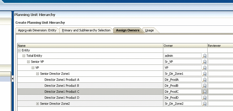

This example uses a hierarchy in which Sr_VP has write access to entity Senior VP and all of its descendants, user VP has access to entity VP and all of its descendants, and so on.

In this example, assume that another user logs on as Dir_prodD and promotes Director Zone1 Product D Planning Unit so that Senior Director Zone1 becomes the owner of this planning unit. Then user Dir_prodA logs on, selects Tools, then Manage Approvals. Then the user selects Scen1 and Ver1, clicks Go, and then selects View, then Level Status. User Dir_ProdA has read access to IDescendants (Director Zone1) and write access to entity Director Product A. Due to this access, user Dir_ProdA sees two options in the Level Reached drop-down list: My Level and 1 Level above.
