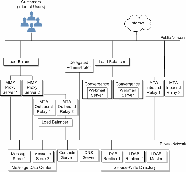

A two-tiered messaging architecture provides the optimum design for scalability and reliability. Instead of having a single host run all the components of a messaging system, a two-tiered architecture separates the components onto different machines. These separate components perform specific specialized functions. As the load for a particular functional component increases-for example, more Message Storage is required, or more outbound relaying is needed-you can add more servers to handle the larger loads.
The two-tiered architecture consists of an access layer and a data layer. The access layer is the portion of the architecture that handles delivery, message access, user login, and authentication. The data layer is the portion of the architecture that holds all the data. This includes the LDAP master servers and Messaging Server machines that are configured to store user messages.
Figure 3-1 shows an example two-tiered architecture.
Figure 3-1 Two-Tiered Messaging Server Architecture
The following describes each of these functional pieces.
Public Access Network. The network connecting the Messaging Server to internal users and the Internet. Each deployment defines its own network requirements; however, the basic Messaging Server requirement is connectibility to end users and the Internet using standard protocols such as SMTP, POP, IMAP, and HTTP.
Private Data Network. This network provides secure connectivity between the public access network and Messaging Server data. It consists of a secure access layer and a data layer, which includes the service-wide directory, the message data center, and the contact server.
LDAP directory server. Directory server used for storing and retrieving information about the user base. It stores user and group aliases, mailhost information, delivery preferences, and so on. Depending on your design requirements, there could be more than one identical directory for the system. Figure 3-1 shows a master directory and two replicas. An LDAP directory server is provided as part of the Messaging Server product. If desired, you can use data from an existing Directory Server. The data format of the existing directory must also be compliant with the Messaging Server schema.
Message Store. Holds and stores user mail. Sometimes referred to as a ”back end.” The Message Store also refers to the Message Access Components such as the IMAP server and the POP server. Figure 3-1 shows a deployment that has two message stores. You can add more stores as needed.
When deploying Cassandra message store, the store architecture changes. Instead of a "Message Data Center" with "Message Store Host 1" and "Message Store Host 2," you deploy store affinity groups with message access hosts running IMAP and LMTP processes. For more information, see Messaging Server Installation and Configuration Guide for Cassandra Message Store.Contacts Server. Stores and retrieves users' addresses in an LDAP server, which can be the same server or a different server from the LDAP server described above.
DNS server. Maps host names to IP addresses. The DNS server determines what host to contact when routing messages to external domains. Internally, DNS maps actual services to names of machines. The DNS server is not part of the Messaging Server product. You must install an operating DNS server prior to installing Messaging Server.
Load Balancer. Balances network connections uniformly or by algorithm across multiple servers. Using load balancers, a single network address can represent a large number of servers, eliminating traffic bottlenecks, allowing management of traffic flows and guaranteeing high service levels. Figure 3-1 shows load balancers for the MMPs and the MTA submission servers. Load balancers are not part of the Messaging Server. You cannot use load balancers on the Message Store or directory masters. You use them for connections to MMPs, Convergence, MTAs submission servers (port465/587), and directory consumers.
MTA Inbound Relay. MTA dedicated to accepting messages from external (Internet) sites and routing those messages to internal hosts and the local Message Store server. Because this is the first point of contact from the outside, the MTA inbound relay has the added responsibility of guarding against unauthorized relaying, spam filtering, and denial of service attack. You can use MX records to balance incoming mail traffic. See "Mail Exchange (MX) Records" for more information. MTA relays on configured to use port 25 get automatic load balancing from DNS MX records. A load-balancer is fine for a Message Submission MTA (port 465/587).
MTA Outbound Relay. MTA that only receives mail from internal or authenticated users and routes those messages to other internal users or to external (Internet) domains. While a single machine can be an inbound relay as well as an outbound relay, in a large scale Internet-facing deployment, separate these functions to two separate machines. This way, internal clients sending mail do not have to compete with inbound mail from external sites.
Delegated Administrator Server. Provides a GUI management console for administrators, enabling more advanced administrative tasks, such as adding and deleting users.
Messaging Multiplexor or MMP. Enables scaling of the Message Store across multiple physical machines by decoupling the specific machine that contains a user's mailbox from its associated DNS name. Client software does not have to know the physical machine that contains its Message Store. Thus, users do not need to change the name of their host message store every time their mailbox is moved to a new machine. When POP or IMAP clients request mailbox access, the MMP forwards the request to the Messaging Server system containing the requested mailbox by looking in the directory service for the location of the user's mailbox. When you use multiple MMPs, they should be located behind a load balancer.
Webmail Server or mshttpd daemon. Provides email services to Convergence clients by using HTTP. In previous versions of Messaging Server, the Webmail Server accessed the Message Store directly. Now, the Webmail Server accesses the Message Store through the IMAP server. Such an architecture enables Convergence clients to access shared folders that are located in different back-end Message Stores. Additionally, there is no longer a requirement to install the Webmail Server on each back-end server. The Webmail Server can act as a front-end server performing multiplexing capabilities.
We only support mshttpd talking to our IMAP and our MTA. We only support Convergence talking to mshttpd. The WMAP protocol mshttpd exposes is not intended for use by third parties. The mshttpd ports (8990, 8991) should be fire-walled so only the Convergence front-ends can talk to it. Or the mshttpd service should be disabled as it is by default.

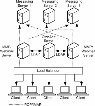

To distribute load across servers is to divide clients' mail evenly across several back-end Message Stores. You can divide up users alphabetically, by their Class of Service, by their department, or by their physical location and assign them to a specific back-end Message Store host. For Cassandra message store (and classic message store automatic failover), the Message Store host is replaced by Message Store affinity group. For classic message store without automatic failover, the affinity group refers to a single host or two hosts with HA failover.
Figure 3-2 shows a sample deployment where users are spread across multiple back-end servers and multiplexors enabled to handle incoming client connections.
Figure 3-2 Spreading Your User Base Across Multiple Servers
Spreading users across back-end servers provides simplified user management, as long as you use MMPs or Webmail Servers. Because users connect to one back-end server, where their mail resides, you can standardize setup across all users. This configuration also makes administration of multiple servers easier to manage. And, as the demand for more Messaging Server hosts increases, you can add more hosts seamlessly.
