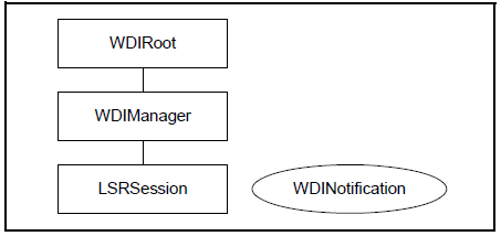

Figure 1-1 shows the relationship of the interfaces in the LSR API.

To begin a connection, the third-party application must connect to the MetaSolv Solution Application Server. This connection verifies the user ID and password, and returns the object reference to the API server's WDIRoot. A successful connect operation on the WDIRoot object returns an object reference to a WDIManager object.
The LSR API's WDIManager interface enables LSRSession, signal, insignal, and transaction management. Table 1-2 describes the operations in the WDIManager interface.
