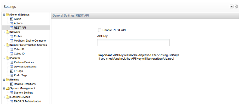

To enable your API Key:
  1. From the Settings menu, select General Settings, and then select REST API.
  2. Select the Enable REST API option, which generates a new API Key.
If the Enable REST API option is deselected, the API Key will automatically be deleted, which disables the REST API. For more information how to use the API Key and the new REST API, see "Getting Started".
Important:
It is strongly recommended that you store your API Key in a safe and secret place. For example, your script's configuration files.
Important:
After closing the Settings dialog box the API Key will no longer be displayed. The API Key is displayed only once when it is first created.
Figure 11-1 shows the General Settings REST API page.
Figure 11-1 How to Enable the New REST API
Description of Figure 11-1 follows
Description of ''Figure 11-1 How to Enable the New REST API''

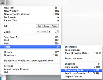

Go ahead and open the developer tools so that we know what's going on in the background. Click the Customize and control Google Chrome icon to access Developer Tools as shown in Figure 11-3:
Figure 11-3 Accessing the Google Chrome Developer Tools
Description of Figure 11-3 follows
Description of ''Figure 11-3 Accessing the Google Chrome Developer Tools''

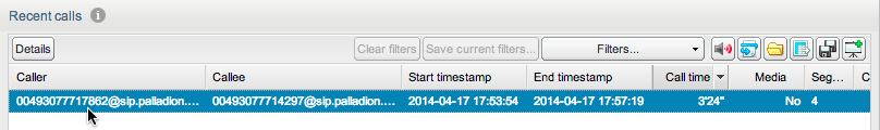

In the Recent calls section of the web interface of Operations Monitor, double click on any call to open up the call details dialog, as shown in Figure 11-5.
Figure 11-5 Double Click on a Call to See Details
Description of Figure 11-5 follows
Description of ''Figure 11-5 Double Click on a Call to See Details''

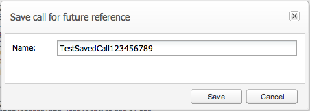

Now it's time to name the to be saved call. Please use the name TestSavedCall123456789 or a name that will be easily recognizable as your custom name as shown in Figure 11-7.
Figure 11-7 Adding a Custom Name
Description of Figure 11-7 follows

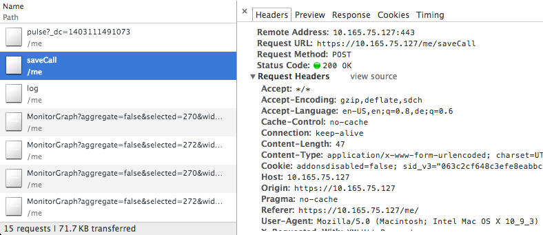

Next, if you click Save, you should see a saveCall https call popup in the network monitoring section of the developer tools as shown in Figure 11-8. You may go ahead and stop the recording of network activity at this point as we have all the info we need to find out how to use this call in the future.
Figure 11-8 saveCall https Call Popup
Description of Figure 11-8 follows
Description of ''Figure 11-8 saveCall https Call Popup''

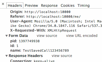

Scroll down to the section Form Data as shown in Figure 11-9.
Figure 11-9 The Form Data Section of the saveCall Request
Description of Figure 11-9 follows
Description of ''Figure 11-9 The Form Data Section of the saveCall Request''
Here we can easily read out the parameters for the saveCall request:
  • pid
    The Process ID of the call we opened and saved.
  • id
    The ID of the call we saved.
  • name
    The name for the saved call as previously entered.
If you now switch to Preview tab of the request we can discover the returns of this call as shown in Figure 11-10:
  • saved_id
    The saved_id of the call we just saved. In the future we may use this to identify this call instead of using the id and pid parameter.
  • success
    This field is always part of the return if no error occurred.
