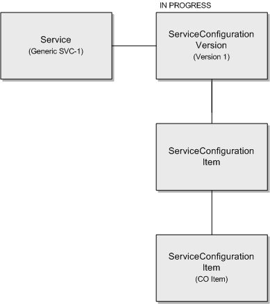

The generic service fulfillment scenario is a Service entity with a single Custom Object resource assignment. The example Service entity is simplified, but the API descriptions are applicable and extensible to other types of services with various types of resource assignments.

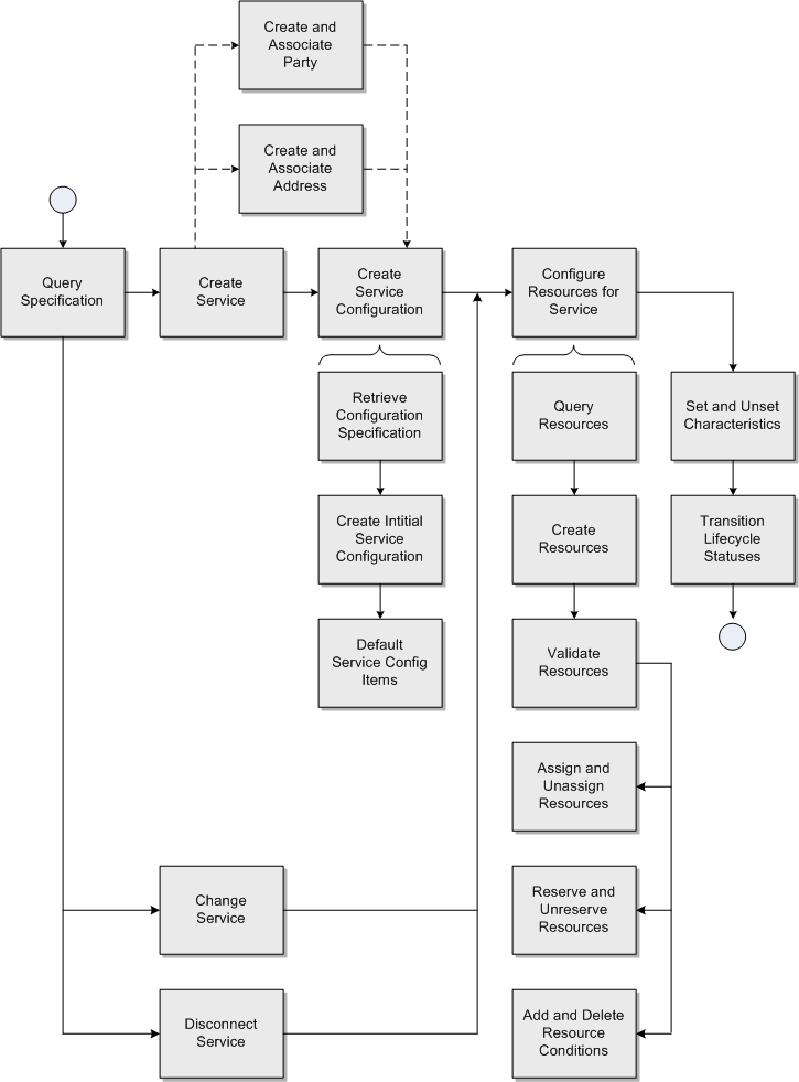

Figure 3-1 shows the process flow for a generic service fulfillment scenario:
Figure 3-1 Process Flow of Generic Service Fulfillment Scenario
Surrounding text describes Figure 3-1 .
The process flow begins with querying for the service specification, which is used in subsequent steps in the process flow, such as creating the Service and searching for resources.
The process flow continues with creating the service, based upon the retrieved service specification.
Next is creating the service configuration, which involves querying for the service configuration specification, creating the service configuration based upon the retrieved service configuration specification, and any creating default service configuration items.
The process flow continues with the optional steps of creating additional entities, such as Party and Geographic Address (a concrete Geographic Place entity representing a Service Address). These entities are created and associated to the Service with specific inventory roles.
Next in the process flow is configuring the resources for the service (resource management), which involves querying for resources based on specific criteria using core API searches or using custom searches. For example, you can call an API directly to search for a Custom Object by ID, or you can call a custom API to search for a Custom Object by its association to an Inventory Group or association to another Custom Object. You can also create resources for immediate assignment to the service. The main goal of resource management is to retrieve and validate the correct resources for assignment to the service. However, you can also manage the resources with alternate flows, such as creating reservations and conditions. Assignments, reservations, and conditions are the main consumption concepts for a given resource.
In addition to resource assignments, the service and service configuration also have characteristic values. These values are used to setup and configure the service instance.
After the service has been configured through resource and characteristic value assignments, the process flow continues with transitioning the lifecycle status of various entities. APIs are presented to show the transition of the statuses, and how the statuses are managed within the core API functionality.
The process flow shown in Figure 3-1 shows the initial creation of the service, and also shows other scenarios, such as changing the service configuration and disconnecting the service. These additional scenarios are also described.

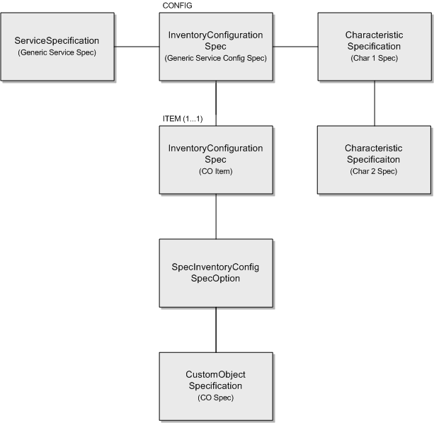

Figure 3-2 shows the generic service configuration specification used in the generic service fulfillment scenario:
Figure 3-2 Generic Service Configuration Specification Example

Figure 3-3 shows how the service and configuration are created by calling the APIs described in Creating the Service and Service Configuration.
Figure 3-3 Generic Service Example
Surrounding text describes Figure 3-3 .
