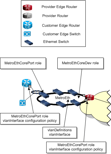

Consider a single Metro Ethernet ring.
Figure 6-2 illustrates the application of VLAN role and configuration policies.
To assign VLAN roles and configuration policies as in Figure 6-2:
In the IP Service Activator client, take the devices that are in the Metro Ethernet network and group them into the same network (for example, MetroEth).
Create a custom role called MetroEthCoreDev to identify devices that are included in the MetroEth network.
For information on creating a role, see IP Service Activator User's Guide.
Apply the MetroEthCoreDev role to all devices in the MetroEth network.
Create another custom role called MetroEthCorePort to identify trunk ports.
Apply the MetroEthCorePort role to each trunk port.
Apply the vlanDefinitions configuration policy to the MetroEth network and apply the role MetroEthCoreDev.
All devices in the network will receive the VLAN configuration specified by the vlanDefinitions configuration policy.
Apply the vlanInterface configuration policy to the MetroEth network and apply the role MetroEthCorePort.
All trunk ports in the network will receive the VLAN interface configuration specified by the vlanInterface configuration policy.
