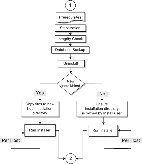

The flow charts in Figure 9-1 and Figure 9-2 illustrate the upgrade process.

Perform the general steps in this section on the old release prior to upgrading. For more specific information about some of these steps, see the relevant sections in this chapter as described in the following procedure.
To prepare to upgrade to the latest release:
Ensure that your old version of IP Service Activator is running.
Log in to IP Service Activator client using a Super User ID.
Ensure outstanding and scheduled transactions are completed.
Attempt to resolve all faults prior to upgrade.
Decide whether to delete or save committed IP Service Activator transactions.
Deleting committed transactions prior to upgrading speeds up IP Service Activator startup time. Saving truncated versions of committed transactions increases IP Service Activator startup time but maintains database records for business purposes. Truncation removes the operations associated with the committed transactions.To delete all committed transactions:
Set the transaction archive limit to zero. See the section about setting the archive limit for transactions in IP Service Activator System Administrator's Guide.
Export all transactions. See the section about exporting transactions in IP Service Activator User's Guide.
Commit the transaction. See the section about committing transactions in IP Service Activator User's Guide.
To save committed transactions:
You can save truncated versions of committed transactions during the upgrade process when you upgrade the database. See "Running dbUpgrade to Upgrade the Database" for more information.
Shut down the IP Service Activator processes. See IP Service Activator System Administrator's Guide for more information.
Run the Integrity Checker from the old IP Service Activator system.
For the Integrity Checker procedure and parameter details, see the Database Integrity Checker topic in IP Service Activator System Administrator's Guide.
Review Integrity Checker output files and correct errors.
If you correct errors, you might have to restart the system to implement the corrections. If you restart the system, return to the first step in this section.
Back up your IP Service Activator database instance.
Save the database back-up in a directory so that it is available for later restoration if a roll-back of the upgrade is required.
Back up custom cartridges, if installed. For more information, see "Backing Up Custom Configuration Policies and Cartridges".
Back up IP Service Activator. For more information, see "Backing Up IP Service Activator".
Uninstall the old IP Service Activator release using the documentation that corresponds to that release.

If you are installing in the same location as the previous installation, follow these general steps. For more specific information, see the relevant sections.
Your system is still shut down when you proceed with upgrading steps.Note:
This section is to upgrade IP Service Activator when the old and new releases are in the same location. If you want to upgrade IP Service Activator where the new release is in a different location, see "Upgrading IP Service Activator to a New Location".To upgrade IP Service Activator to the latest release:
