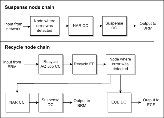

About Suspense and Recycle Node Chains
To suspend and recycle records and batches in Offline Mediation Controller, you create a suspense node chain and a recycle node chain. Figure 4-1 shows the suspense and recycle node chains.
Figure 4-1 Suspense and Recycle Node Chains
Description of Figure 4-1 follows
Description of ''Figure 4-1 Suspense and Recycle Node Chains''
The suspense node chain does the following:
  1. A node, such as an EP node, finds an error in a record or batch.
  2. The node where the error was found sends the record or batch to the NAR CC node.
  3. The NAR CC node reads the record of batch from the suspense directory and prepares the record or batch for further processing.
  4. The NAR CC node sends the record or batch to the Suspense CD.
  5. The Suspense CD node sends the record or batch to BRM to be processed by Suspense Manager. To do so, the Suspense CD node generates a Create file.
The recycle node chain does the following:
  1. The Recycle Job AQ CC node receives a record or batch from BRM and prepares the record or batch for further processing. To identify the record or batch, the Recycle Job AQ CC node receives the job ID message from the Oracle AQ queue.
  2. The Recycle Job AQ CC node sends the record or batch to the Recycle EP node.
  3. The Recycle EP node uses the job ID message to sends the record or batch to the node that reported the original error.
  4. If no errors are found, the record or batch is sent to two nodes:
    • The next node in the node chain. In Figure 4-1 this is the ECE DC node.
    • The NAR CC node, which sends the record or batch to the Suspense DC node. The Suspense DC node sends the output to BRM to record that the record or batch was processed successfully. To do so, the Suspense CD node generates an Update file.

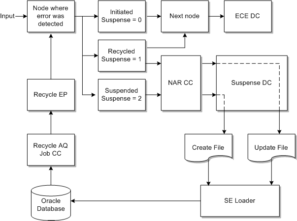

To manage suspending and recycling records and batches, you need to configure nodes to add and update a flag that tracks the status of suspended and recycled records and batches. The status values are:
  • Initialized (0). This flag is set when the node processes the record or batch. If no errors are found, the record or batch is passed to the next node in the node chain. If the status remains at 0, the record or batch is never suspended.
  • Failed (2). This flag is set when an error is found in the record or batch. The record or batch is sent to the NAR CC node, and then to the Suspense DC node, but not sent to the next node in the node chain. The Suspense DC node generates a Create file and sends it to BRM.
  • Successful (1). This flag is set when a record or batch is recycled, and no new error is found by the node that originally found the error. The record or batch is sent to two places:
    • The next node in the node chain; for example, the ECE DC node.
    • The NAR CC node, and then to the Suspense DC node. The Suspense DC node generates an Update file and sends it to BRM to update the record or batch status in BRM Suspense Manager.
Figure 4-2 shows how the suspense flag is used in node chains.
Figure 4-2 Flags Used in Suspense and Recycle Node Chains
Description of Figure 4-2 follows
Description of ''Figure 4-2 Flags Used in Suspense and Recycle Node Chains''
