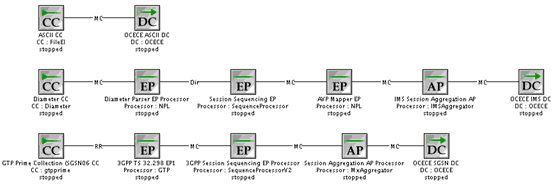

About the ECE Cartridge Pack
The ECE cartridge includes the ECE DC node that enables Offline Mediation Controller to submit offline charging requests to ECE.
The ECE cartridge pack is used with the following existing cartridge packs to process the input records:
  • Simple ASCII
  • IMS
  • SGSN
Figure 4-1 ECE DC Node Configuration Architecture
Description of Figure 4-1 follows
Description of ''Figure 4-1 ECE DC Node Configuration Architecture''

  • version: Set this field to the version for each CDR record corresponding to the product type.
  • operationType: Set this field to the usage type for each CDR record corresponding to the product type.
    See the sample mapping for the ECE cartridge pack in Offline Mediation Controller Cartridge Development Kit NPL Reference Guide for more information about the supported usage types.
For example:
out.cdr_service="VOICE"out.eventType="USAGE"out.version="1.0"out.operationType= "Terminate"
