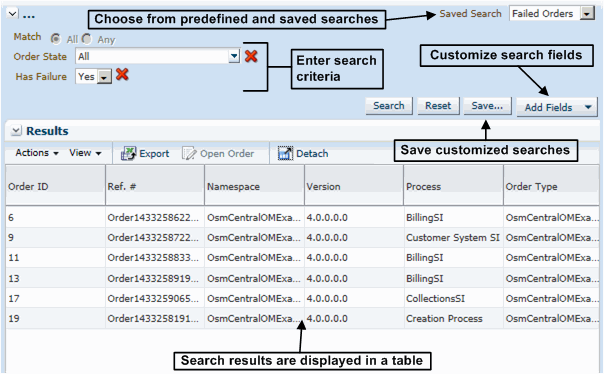

The Order Management web client includes features that enable you to find orders by using a variety of criteria. When you first open it, the application displays the Order Search page.
You can select predefined search or create a customized search by changing the criteria and adding or removing fields. You can save customized searches so that you can use them again. See "Saving a Search."
Figure 2-1 illustrates the Search page and some of its features.

  1. Click Manage Orders in the Orders area if the search screen is not already displayed.
  2. If you want to use a predefined or saved search other than the default, from the Saved Search list, select the search you want to use. The following predefined searches are provided:
    • Minimal Fields: Includes search criteria for a limited set of fields, including order ID, reference number, namespace, and type.
    • Failed Orders: Finds all orders in the Failed state. This is the default search until you specify another as the default. See "Saving a Search" for more information.
    • All Fields: Includes search criteria for all available fields, including the standard fields applicable to all orders with orchestration plans as well as any custom fields defined for a particular orchestration plan.
    If the search you selected is configured to run automatically, it runs automatically when you select it, and you are finished searching unless you want to customize the search.
  3. If you would like to change the fields used as search criteria, do any of the following:
    • To add a field, from the Add Fields list in the Search area, select a field that you want to include.
      The field is displayed in the Search area, along with one or more search operators.
    • To remove a field, in the Search area, click the red X to the right of the field you want to remove.
      The field and its operator are removed.
    • To reset the fields to the way they are in the saved search, in the Search area, click the Reset button.
      The Search area is restored to its last-saved arrangement of fields and operators.
    For more information about the available fields, see "Available Search Fields."
  4. If you would to enter search criteria in any of the fields, enter the data and select the appropriate operators. See "Entering Search Criteria" for more information.
  5. Click the Search button.
    The Order Management web client displays the orders that match your search in the Results area.
