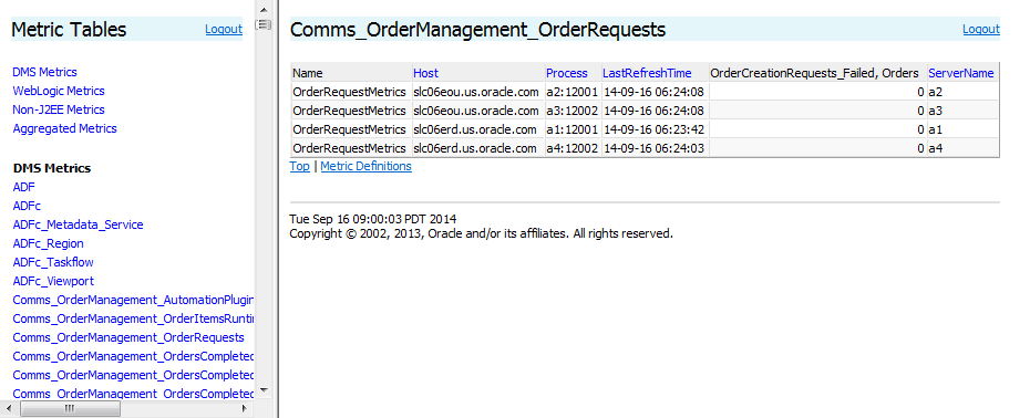

Figure 10-1 shows the DMS user interface for an environment that has Oracle HTTP server configured. A list of links to metrics tables is on the left-hand side. When you click the link to a metrics table, the table opens in the pane on the right.
Figure 10-1 DMS Order Requests Metrics Table
Description of Figure 10-1 follows
Description of ''Figure 10-1 DMS Order Requests Metrics Table''
To view metrics tables using DMS:
  1. In a browser, enter one of the following URLs:
    http://hostname:port/dms
    https://hostname.dnsdomainname.tld:sslport/dms
    where hostname is the name of the WebLogic administration server, port is the port for the administration server domain, and sslport is the secure port for the administration server domain.
    The DMS Spy login screen is displayed.
  2. Log in using your WebLogic username and password.
    A list of all metric table names is displayed.
  3. Click the metric table name for the table that you want to view.
    The details of the metric table are displayed in the right-hand pane.
    For any table, you can display a list of the metric column names, a description of each column name, and the derivatives and units for the metric. To view this information, click the Metric Definition link at the bottom of the table.

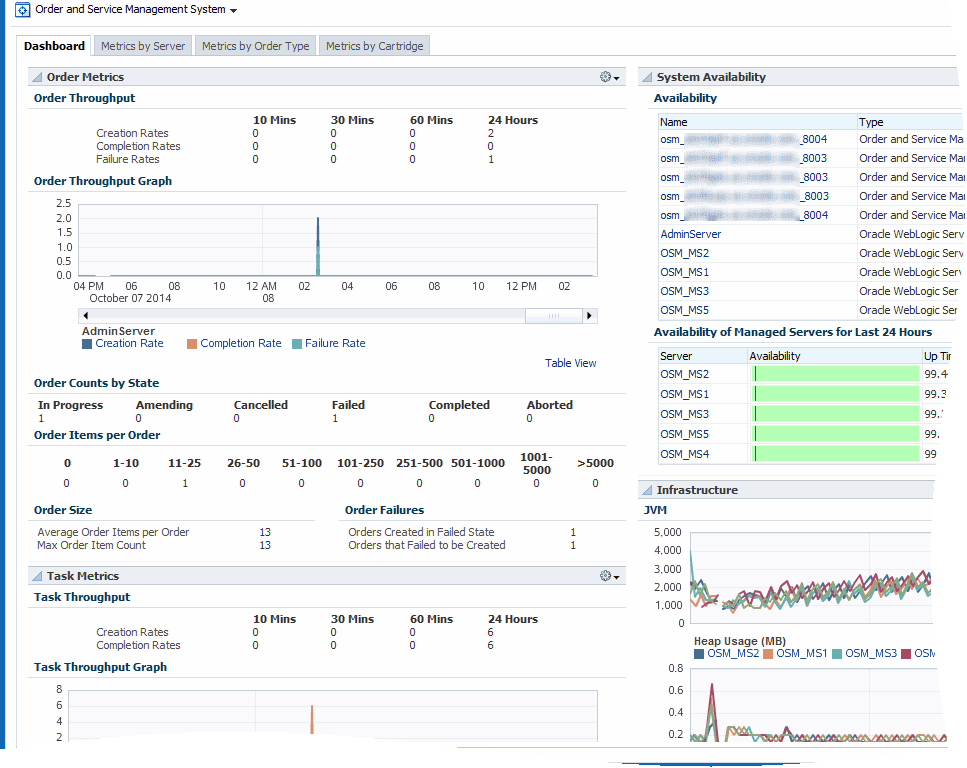

You can also view that same data using the Application Management Pack, which is a plug-in that is available in Enterprise Manager. This view provides a graphical representation of metric data, which allows you to analyze and interpret data over time. For information about viewing metrics using Enterprise Manager, see Oracle Fusion Middleware Performance and Tuning Guide. For information about using Application Management Pack, see Oracle Application Management Pack for Oracle Communications System Administrator's Guide.
Figure 10-2 shows the Application Management Pack dashboard for an OSM system. The interface also displays metrics by server, order type, and cartridge.
Figure 10-2 OSM System Data in the AMP Dashboard
Description of Figure 10-2 follows
Description of ''Figure 10-2 OSM System Data in the AMP Dashboard''
