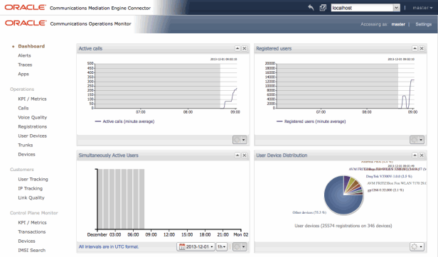

Figure 1-1 shows the Mediation Engine Connector dashboard.
Figure 1-1 Mediation Engine Connector Dashboard
The Mediation Engine Connector dashboard is similar to the dashboard of the mediation engines. It allows you to view at a glance important information retrieved from single probes, as well as information aggregated from all mediation engines. The dashboard contains a configurable number of panels, which can be added or removed by the user. The following functionality is available for the Mediation Engine Connector dashboard.

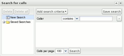

The Call Search panel allows you to specify the search criteria and display matching unique calls on all probes simultaneously.
Figure 1-2 shows the Call Search panel.
The Call Search panel provides the following functionality:
Enter search criteria: To enter the search criteria, click Add search criteria button and select the field for which you want to enter a search criterion. A new row appears in the center-right area of the Call Search panel. You can enter a comparison operator and a comparison value for the criterion in this row.
Execute a search: Click Search to execute the active search. The Call Search Results page appears.
Save search and retrieve saved searches: You can save a search by clicking Save Search. A new node appears in the tree to the left of the panel, under the Saved Searches folder. To give a name to the saved search, click the tree node for the search and enter a name. To retrieve a previously saved search, click select a node from under the Saved Searches folder. You can also delete a saved search by selecting its node and clicking Delete. Clicking Delete all deletes all saved searches. Note, that saved searches will be gone, once you reload the page or logout from Mediation Engine Connector and login again.

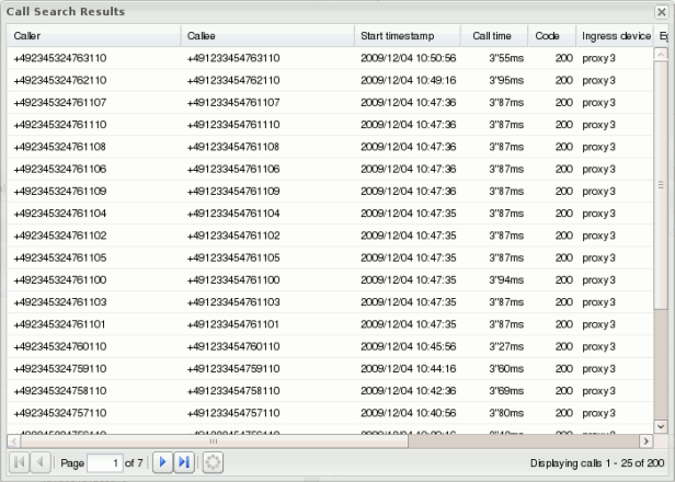

Call Search Results page: The Call Search Results page appears after you execute a search and displays unique calls that match the search criteria found on all mediation engines.
Figure 1-3 shows an example of the call search results.

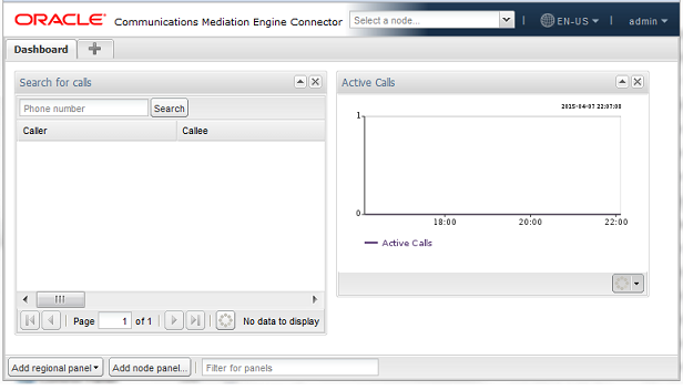

The Active Calls counter panel displays a chart which is computed based on values aggregated from all mediation engines. Currently the active calls counter is available. It is the only option present in the dashboard add panel wizard, when you choose Display a counter.
Figure 1-4 shows the Active Calls counter panel.
