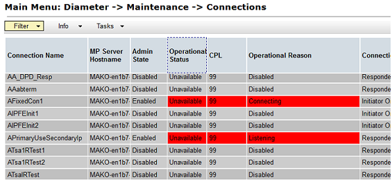

  1. Navigate to Diameter > Maintenance > Connection to monitor IPFE Connection status.
