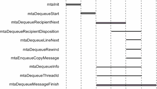

The following basic steps are necessary to dequeue messages:
Initialize SDK resources and data structures with mtaInit().
Call mtaDequeueStart(), passing it the address of the caller-supplied routine that is to be used to process each message. When mtaDequeueStart() is called, it does not return until all queued messages requiring processing have been processed, thus blocking the thread calling it until it is finished.
For each queued message requiring processing, an execution thread created by mtaDequeueStart() calls the routine whose address was provided in Step 2. Threads created by mtaDequeueStart()mtaDequeueStart() each sequentially process multiple messages. That is, mtaDequeueStart() does not create a distinct thread for each and every queued message to be processed. For a list of the tasks the processing routine should do, see "Caller-Supplied Processing Routine".
The mtaDequeueStart() routine will use one or more threads, with each thread calling the message processing routine. The maximum number of threads allowed can be set when calling mtaDequeueStart(). Consequently, a program that does not support threading should specify a maximum of one thread when it calls mtaDequeueStart().For a list of the tasks the processing routine should do, see "Dequeue Message Processing Routine Tasks".
After mtaDequeueStart() returns, deallocate SDK resources and data structures with a call to mtaDone().
Channel programs typically perform some form of processing on each message they dequeue. For instance, virus scanning, MMS conversion, decryption, delivery to a proprietary messaging system, and so forth. When using the MTA SDK, channel programs must provide a routine which initiates this processing on a per message basis. That is, programs must supply a routine that to be called to process a single queued message. Throughout the rest of this text, this caller-supplied routine will be referred to as "the caller-supplied processing routine" or, for short, "the processing routine."
When called by one of the mtaDequeueStart() execution threads, the processing routine uses the SDK to access the message's envelope, header, and any content. Upon completion of processing, the message is then either removed from the MTA queues, or, in the event of a temporary error, left in its queue for a later processing attempt.
The processing routine processes a single queued message per invocation. The specific steps that a processing routine takes are:
Read the envelope recipient list with repeated calls to mtaDequeueRecipientNext(). When mtaDequeueRecipientNext() returns the MTA_EOF status code, the list has been exhausted and all envelope recipient addresses have been provided. All queued messages are guaranteed by the MTA to always have at least one envelope recipient address.
Read the message, both header and body, with repeated calls to mtaDequeueLineNext(). When mtaDequeueLineNext() returns the MTA_EOF status code, the message has been exhausted; that is, there is no more message text to retrieve. The message will be an RFC 2822 conformant message. As such, the division between the message's header and content will be demarked by a blank line (a line with a length of zero). A message may have no content; that is, a message may have just a header.
Process the message. The processing in this step could be almost anything, including possibly enqueuing a new message or messages with the MTA SDK. The details of this step will depend upon the purpose of the program itself. Programs needing to do MIME parsing should consider using the mtaDecodeMessage() routine. For further information about message processing threads and caller-supplied message processing routines, see "Processing the Message Queue".
Report the disposition of each envelope recipient with per recipient calls to mtaDequeueRecipientDisposition(), or a single call to mtaDequeueMessageFinish() with the MTA_DISP item code. Table 4-1 lists the valid recipient dispositions.

Dequeue the message with mtaDequeueMessageFinish(). The message is not actually removed from the channel queue until this final step. This helps ensure that mail is not lost should the channel program fail unexpectedly, or some other unexpected disaster occurs. When this routine is called, the resulting processing depends on the disposition of the envelope recipient addresses reported with mtaDequeueRecipientDisposition() (see Step 4 in this task list). If all recipients have a permanent disposition (all of the ones listed in the previous table, except MTA_DISP_DEFERRED), then any required non-delivery notifications are generated and the message is permanently removed from the MTA queue. If all recipients are to be deferred (MTA_DISP_DEFERRED), then no notifications are generated and the message is left in the queue for later delivery attempts. If, however, some recipients have a permanent disposition and others are deferred, then the following happens:

When you are constructing programs, there is a calling order for the MTA SDK routines that must be observed; some routines must be called before others.
"Example 4-1 A Simple Dequeue" visually depicts the calling order dependency of the message dequeue routines. To the right of each routine name appears a horizontal line segment, possibly broken across a column, for example, mtaDequeueRecipientNext(). Routines for which two horizontal line segments, one atop the other, appear are required routines; that is, routines that must be called in order to successfully enqueue a message. The required routines are mtaInit(), mtaDequeueStart(), mtaDequeueRecipientNext(), and mtaDqueueMessageFinish().
To determine at which point a routine may be called, start in the leftmost column and work towards the rightmost column. Any routine whose line segment lies in the first (leftmost) column may be called first. Any routine whose line segment falls in the second column may next be called, after which any routine whose line segment falls in the third column may be called, and so forth. When more than one routine appears in the same column, any or all of those routines may be called in any order. Progression from left to right across the columns is mandated by the need to call the required routines.
After calling mtaDequeueRewind(), the read point into the underlying queued message file is reset to the start of the message's outermost header; that is, you are back in the third column. Figure 4-1 shows the calling order dependency for message dequeue routines.
Figure 4-1 Calling Order Dependency for Message Dequeue Routines
