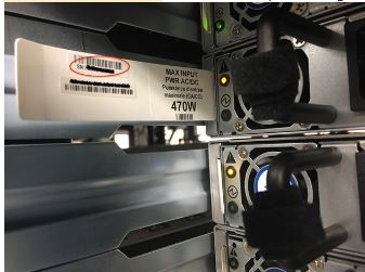

| 12.
Create the files necessary to configure the ToR switches using the serial number from the switch. | The serial number is located on a pullout
card on the back of the switch in the left most power supply of the switch.
