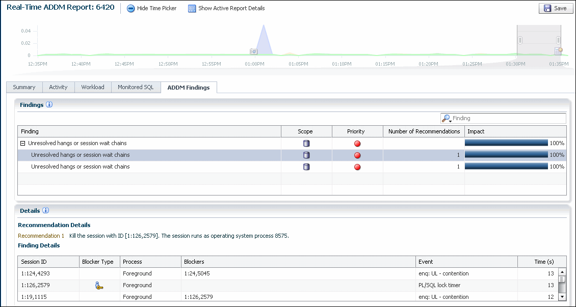

10.2.4 Responding to Real-Time ADDM Findings
You can view the findings in a Real-Time ADDM report.
To respond to Real-Time ADDM performance findings:
  1. To view a particular report in the Real-Time ADDM Reports table, click the link for the report in the Report Name field, or select the table row and then click Show Performance Report.
  2. In the Findings table, the findings for the report, and the impact of each finding are displayed. When you select a finding in the Findings table, the recommendation details and finding details for that finding are displayed in the Recommendation Details and Finding Details sections below the Findings table.
