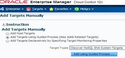

Select “Add Targets” from the “Setup” menu, then choose “Add Targets Manually”.
Select “Add Targets Using Guided Process” on the “Add Targets Manually” page.
Select “Discover NoSQL SNA System Targets” in the “Target Types” drop-down list.
Click “Add Using Guided Process”. This brings up the NoSQL Database Discovery program.

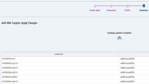

Click “Next” to go to the “Summary” (Add SNA Targets: Apply Changes) page. This shows a report of success or failure of each action.
At this point, you may exit Discovery, or you may click on "Choose Agent", near the top of the page, to return to the first page of the program, to re-start and run discovery on a new agent. Once all of the components of a store have been discovered and added, EM's model of the store's topology is complete.
