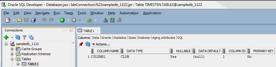

If you are using TimesTen release 11.2.2 or later, then you can specify and display LOB data types in your table definitions.
If you want to create a table with a LOB data type, then in the Create Table dialog, expand the Type column header. You see CLOB, NCLOB, and BLOB as valid data types.
Figure 2-1 Specifying LOB data types in the Create Table dialog
To view the data type for your columns, select the table and then choose the Columns tab. You see the LOB data type for your column.

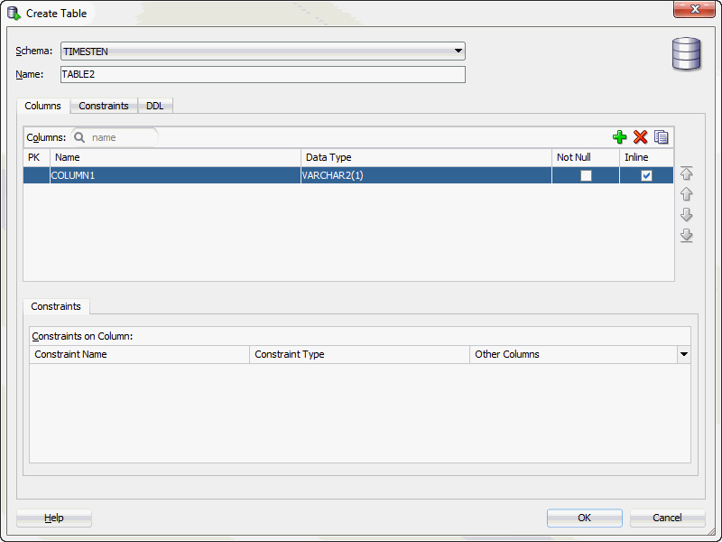

You can specify the INLINE attribute for columns of type VARCHAR2, NVARCHAR2, and VARBINARY.
In the Create Table dialog, locate the column header named Inline. Click in the check box to define the column with the INLINE attribute.
Figure 2-5 Viewing the Inline attribute in the Create Table dialog

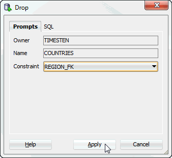

You can drop a constraint from a TimesTen table. Make sure you are on the main SQL Developer page and that your TimesTen connection is expanded.
Click the + to the left of the Tables node to expand the list of tables.
Right-click the name of the table and select Constraint, then select Drop.
The Drop dialog displays. The Owner and Name fields are auto-filled and you cannot edit these fields. Prepare to select the Constraint.
Select the constraint that you want to drop from the Constraint drop-down list.
To view the SQL statement that will be used to drop the constraint, choose the SQL tab of the Drop dialog box.
Click Apply.
The Confirmation dialog box displays indicating that the constraint has been dropped.
Click OK.
The constraint has been successfully dropped.
