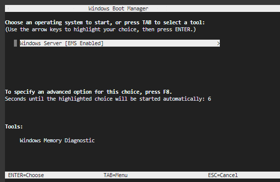

Boot menu commands

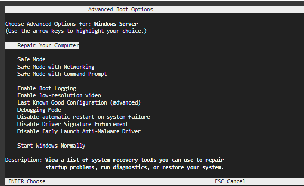

If the instance has the boot menu enabled and is rebooted after connecting through SSH, the Windows boot menu should display in the serial console output. The following list includes commands that you can use with the boot menu:
Boot menu
  • Enter: When the boot menu initiates and the operating system is highlighted, starts the operating system.
  • Tab: Switches to the Tools menu.
  • Esc: Exits the boot menu and restarts the instance.
  • Esc and then 8 or F8: Displays advanced options for the selected item.
  • Esc + left arrow: Returns to the initial boot menu.
Advanced boot options

  1. Access through the Restart button.
    • Click Start on the lower-left corner of the Windows screen.
    • Navigate to the Power options.
    • While holding down the Shift key on the keyboard, click the Restart option.
      Note
      Holding the Shift key triggers the system to reboot into the Advanced Boot Options menu instead of performing a regular restart.
  2. After restart, on the initial Windows Setup screen, select Repair your computer instead of proceeding with a new installation.
  3. In the next menu, select Troubleshoot.
  4. To access the Command Prompt, from the Troubleshoot menu, select Command Prompt. This selection opens the Windows Recovery Console where you can execute commands.

  1. Access the Windows Recovery Console by pressing and holding the Shift key while clicking on the Restart button from the Start menu or login screen.
  2. In the subsequent screen, choose Troubleshoot.
  3. Select Advanced options.
  4. Click Startup Settings.
  5. Choose Restart.
  6. After the computer restarts, you see a list of start up options. Press the appropriate key to enable Safe Mode.
  7. In Safe Mode Windows might prompt you to set a password for the Administrator account if it never had one. When prompted create and confirm a password for the Administrator account.
  8. When you see the message indicating that Windows is running in Safe Mode, click OK.
