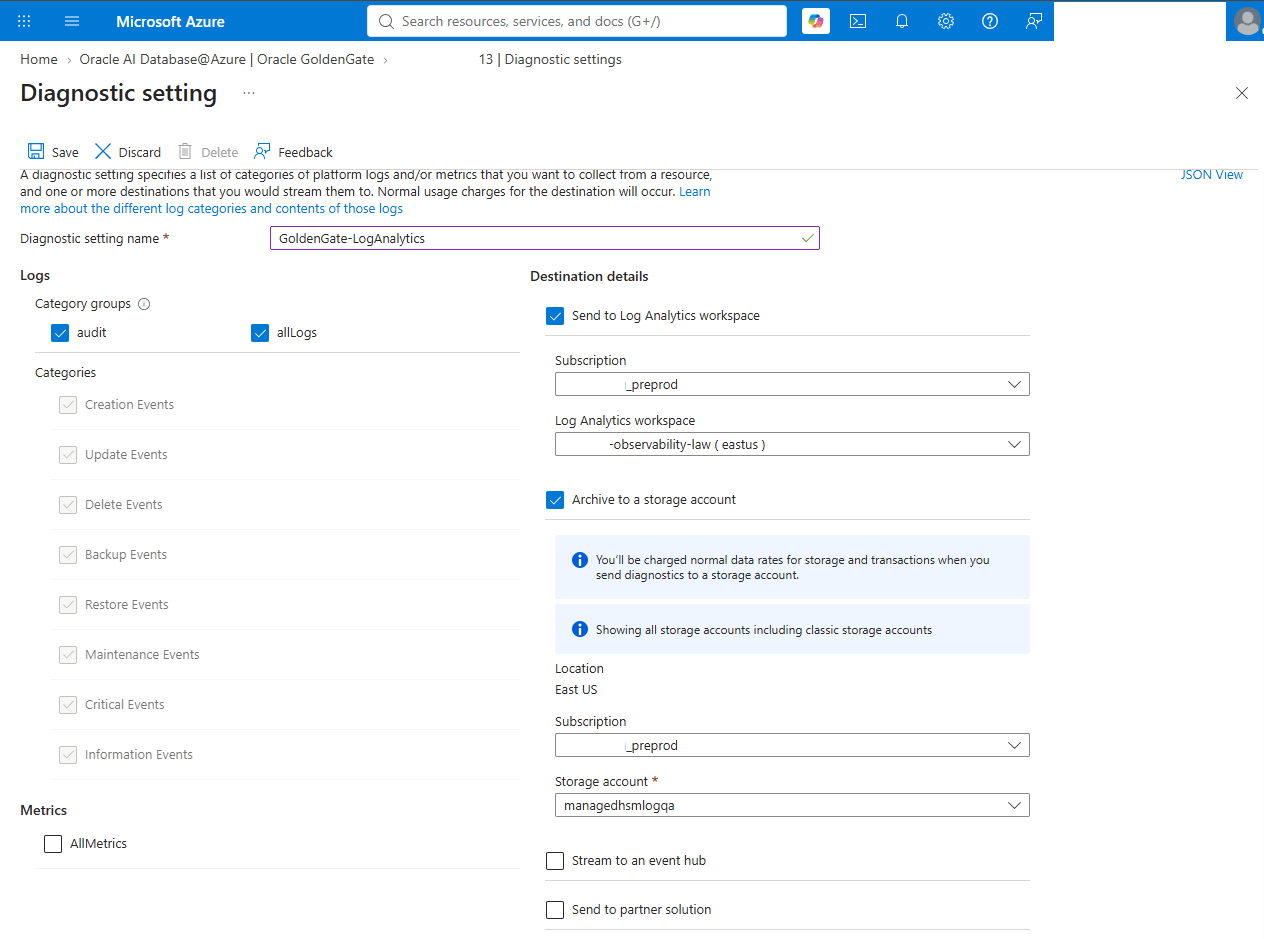

Based on the diagnostic settings page, the service is configured to emit logs and audit-related events.

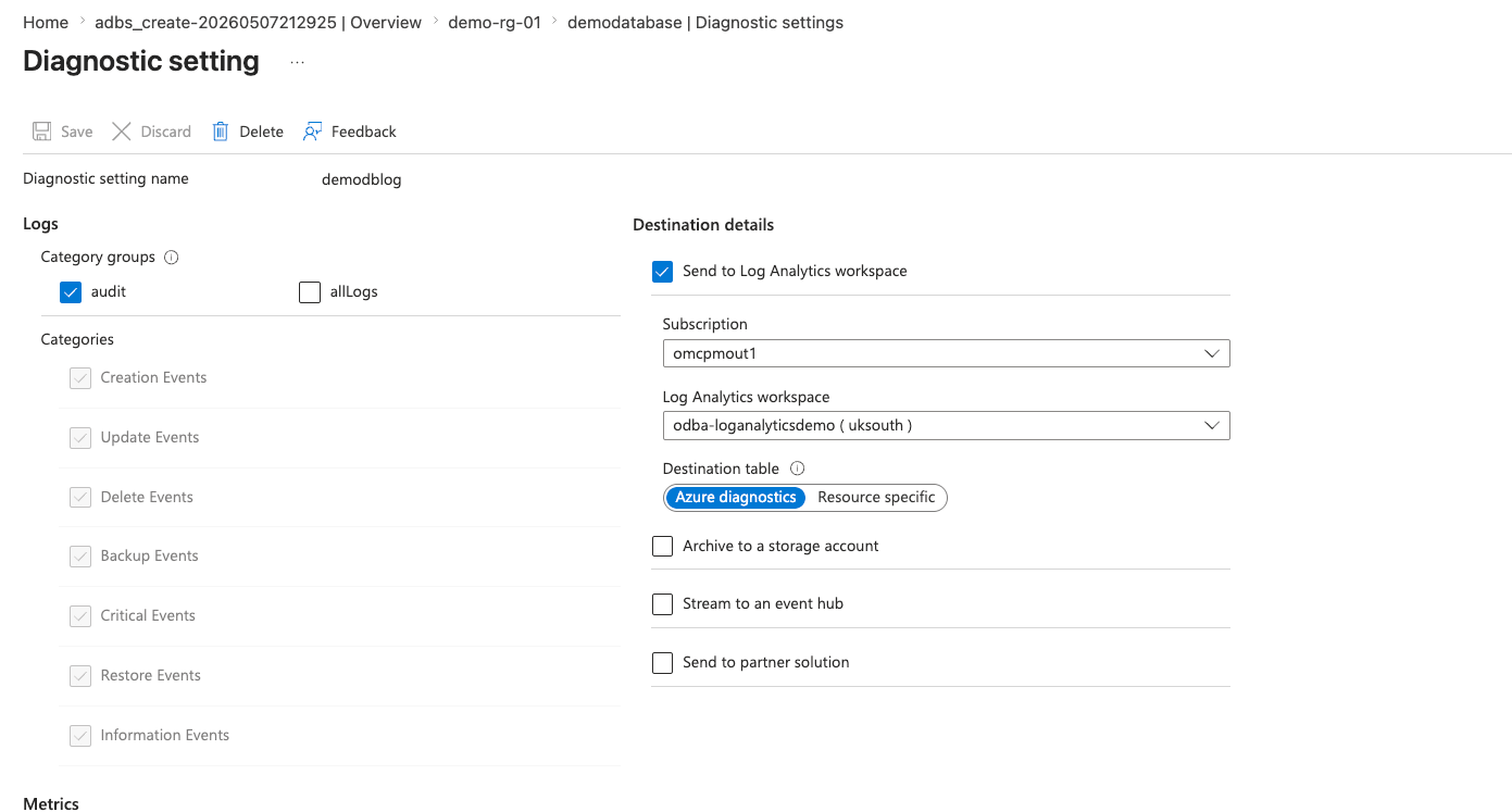

Set Up Log Analytics for Oracle Exadata Database Service on Dedicated Infrastructure
- From the Azure portal, select Oracle AI Database@Azure.
- From the left menu, select Oracle Exadata Database Service on Dedicated Infrastructure and then select Oracle Exadata VM Clusters tab.
- From the list, select your Oracle Exadata VM Cluster that you want to monitor.
- Expand the Monitoring section, and then select Diagnostics settings.
- Select the Add diagnostic setting button. To enable Diagnostic settings ,configure the following event data:
- Creation Events
- Update Events
- Delete Events
- Backup Events
- Critical Events
- Restore Events
- Information Events
- On the Diagnostic Settings page, enter a descriptive Diagnostic setting name and then choose the audit option under Category groups in the Logs section.
- Select Log Analytics Workspace as the destination detail that you created earlier, and then select the Subscription and the Log Analytics workspace.
- Review your information and then select the Save button to save your settings.

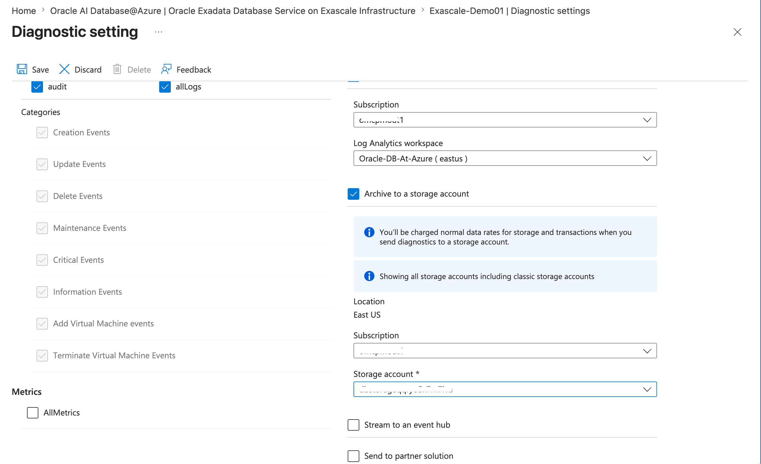

Set Up Log Analytics for Oracle Exadata Database Service on Exascale Infrastructure
- From the left menu, select Oracle Exadata Database Service on Exascale Infrastructure and then select VM Clusters tab.
- From the list, select your Exascale VM Cluster that you want to monitor.
- Creation Events
- Update Events
- Delete Events
- Backup Events
- Critical Events
- Restore Events
Set Up Log Analytics for Oracle GoldenGate
- From the left menu, select Oracle GoldenGate, and then select Oracle GoldenGate Deployments tab.
- Select your deployment that you want to monitor.
- Creation Events
- Update Events
- Delete Events
- Backup Events
- Critical Events
- Restore Events
- On the Diagnostic Settings page, enter a descriptive Diagnostic setting name, and then choose the audit option under Category groups in the Logs section.
- Select the Send to Log Analytics workspace checkbox, and then select the Subscription and the Log Analytics workspace.

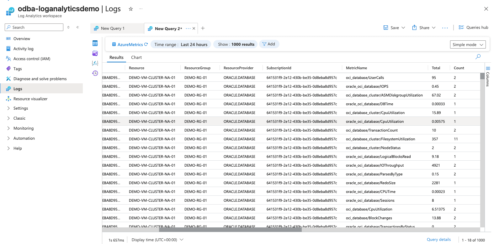

- Explore Data (Simple mode)
- By default, you can see the Simple mode, which provides a spreadsheet-like experience.
- Use point-and-Select filters, sorting, and aggregation to explore available log data.
- Ideal for quick checks such as recent errors, activity logs, or resource health events.

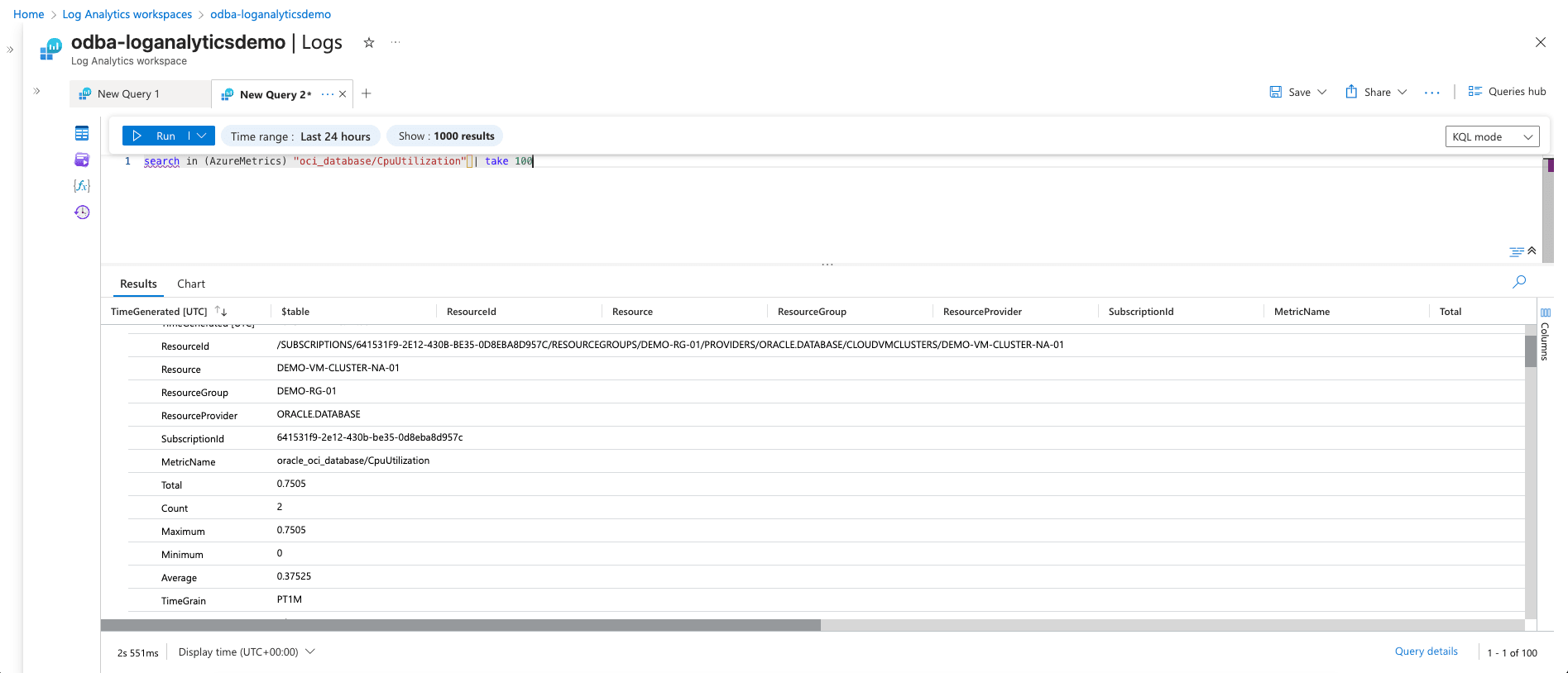

- Query Data Using KQL (Advanced Mode)
- From the dropdown, switch the mode to KQL mode.
- Browse available tables shown on the left side. For example:
AzureMetrics, OracleCloudDatabase, UsageFor more information, see the table reference AzureMetrics, OracleCloudDatabase, and Usage.
- Run a basic query. For example:
- The following query lists CPU Utilization Metrics of all resources in the Exadata Infrastructure which includes VM cluster, Container Database and Pluggable Database.
search in (AzureMetrics) "CpuUtilization" | take 100 - The following query lists CPU Utilization Metrics of all Container Databases.
search in (AzureMetrics) "oci_database/CpuUtilization" | take 100 - The following query lists CPU Utilization Metrics of all Pluggable Databases.
search in (AzureMetrics) "oracle_oci_database/CpuUtilization" | take 100

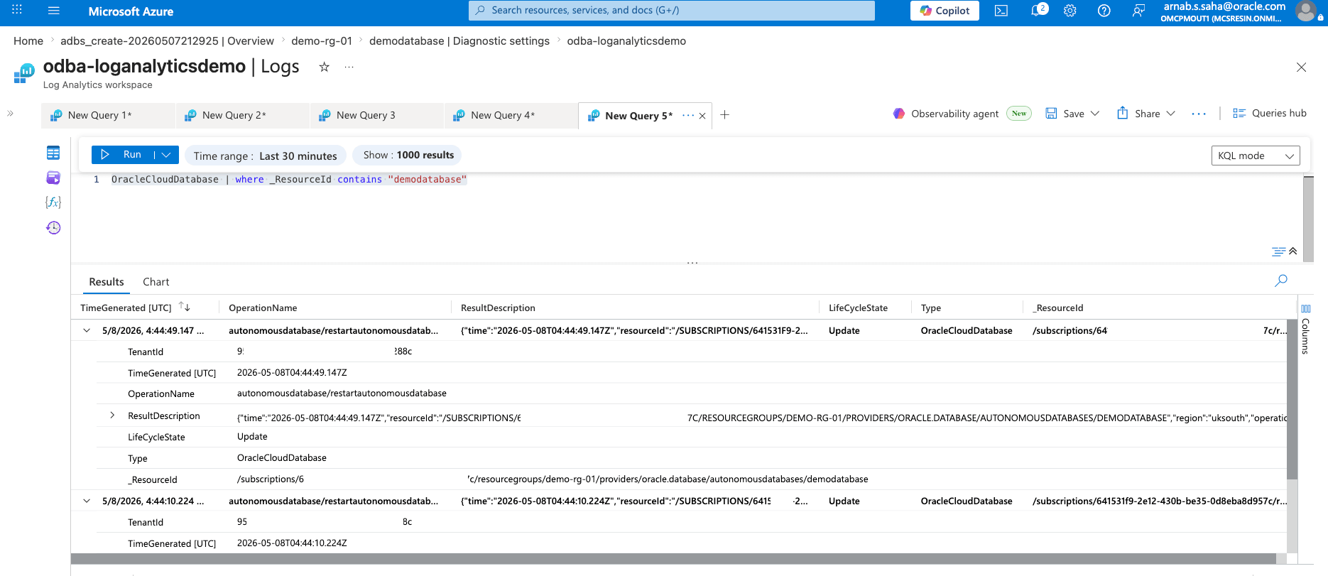

- The following query lists all events in the Autonomous AI Database Serverless for the last 30 minutes.

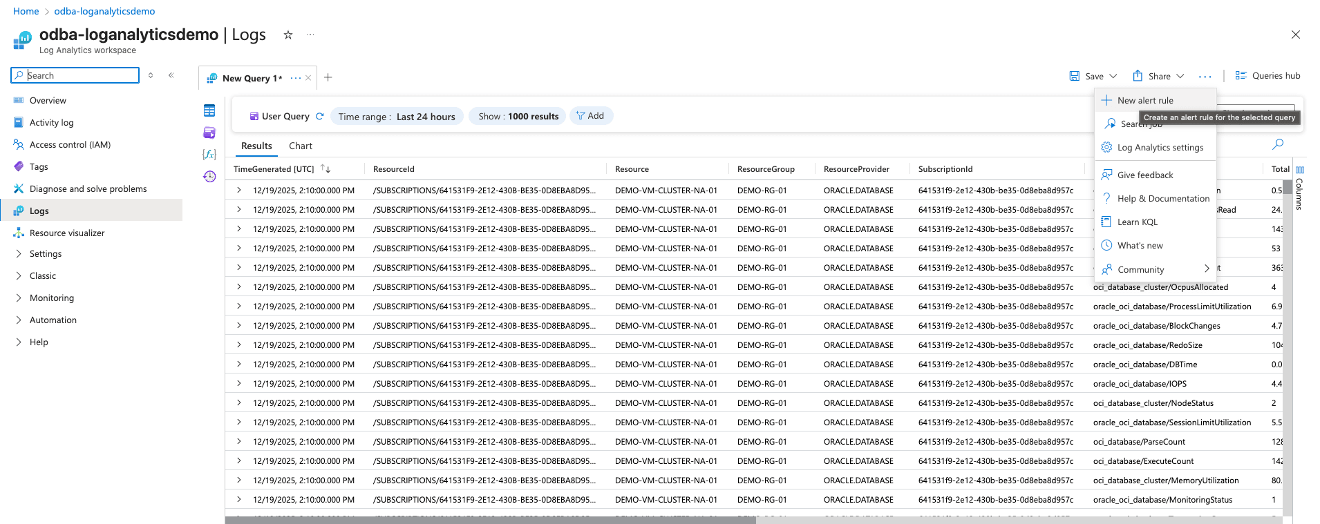

- From the Logs query window, select the ... icon and then select the + New alert rule option. From the Create an alert rule page, enter the following information.
- In the Scope section, the required fields are populated automatically.
- In the Condition section, confirm the Search Query condition and then set the following based on your requirements:
- Measurement: Measure for the aggregation, Aggregation type, Aggregation granularity
- Alert logic: Operator as Greater than, Threshold value and Frequency of evaluation
- In the Actions section, select an existing Action group or Create a new one. For example:
email/SMS/webhook/Logic App/Function. Select the Next: Details button. - In the Details section,
- Enter Alert rule name. This is required field.
- The Alert rule description field is optional.
- Select the Region.
- Choose the Identity which will determine the permissions you have for accessing Azure Data Explorer and other resources when the query is running.
- The Tags section is optional. Tags are name and value pairs that enable you to categorize resources and view consolidated billing by applying the same tag to multiple resources and resource groups.
- Review your information, and then select the Create button to enable alert rule.
