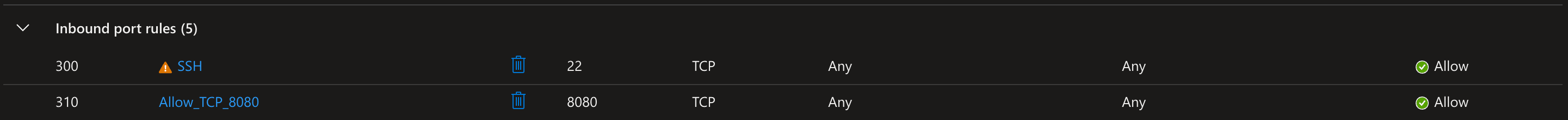

  • Ensure that port 8080 is open in your Azure Network Security Group settings.This screenshot shows how to ensure that the port is set correctly.

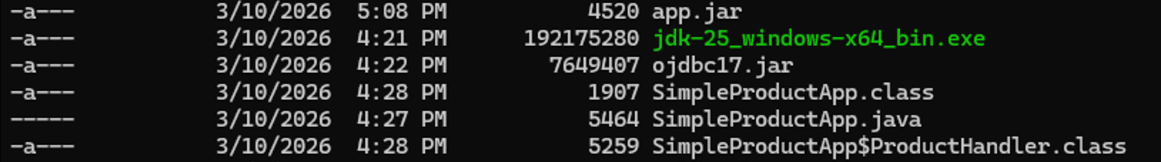

    5. After a successful compile and package, output directory will have additional files created as app.jar.This screenshot shows the directory files.

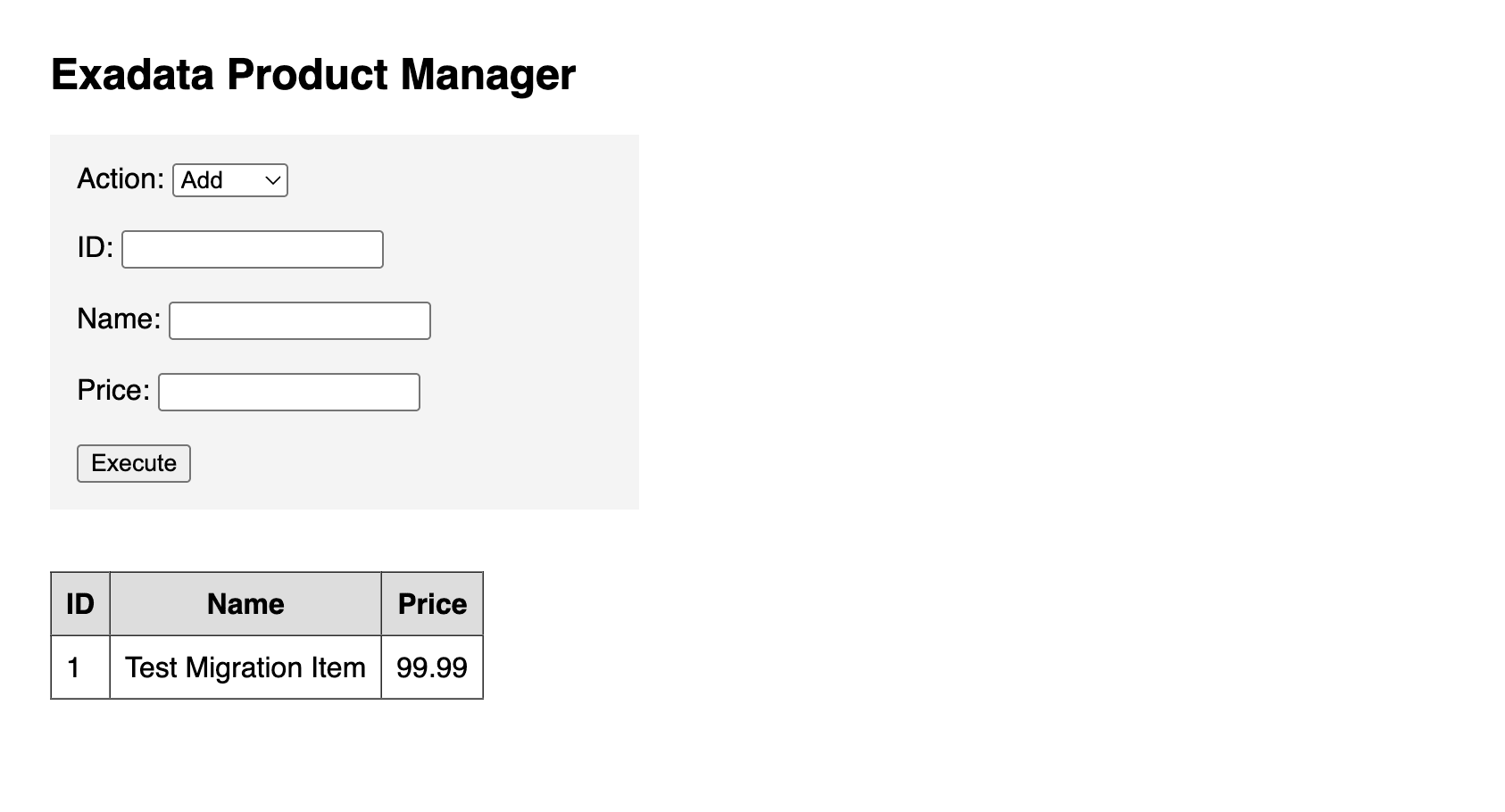

    5. After the application starts successfully, the UI displays options to manage Products.This screenshot shows the UI to manage the Products.
