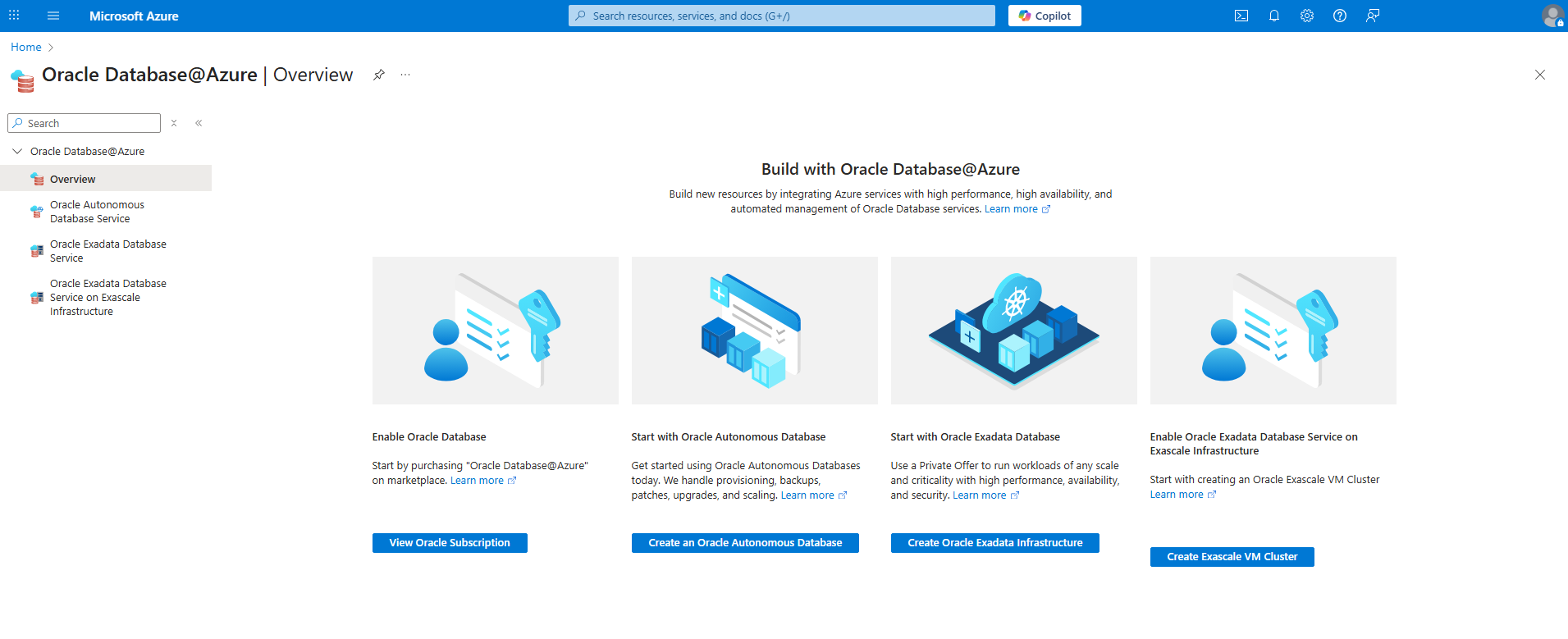

  1. Sign in to the Azure Portal and navigate to the Oracle AI Database@Azure Overview page. You can find this page by searching for "Oracle AI Database@Azure" in the Azure portal search.

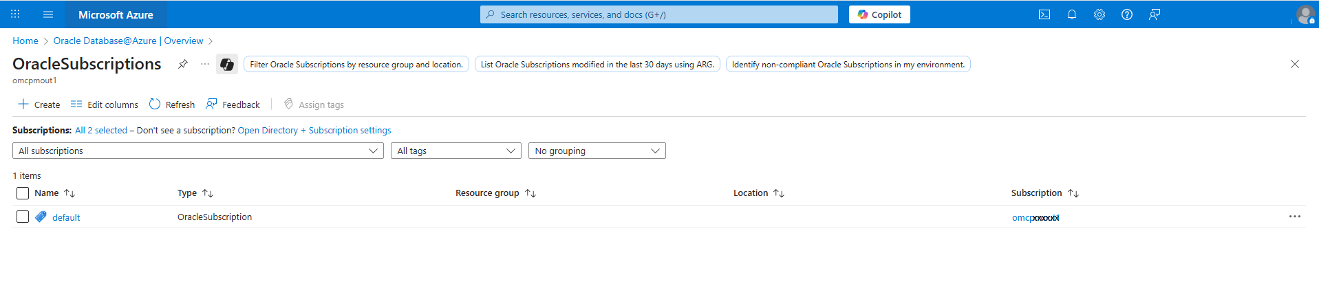

  2. Select View Oracle Subscription to go to the list of OracleSubscription resources. This list represents Oracle AI Database@Azure offers that have been accepted. For most customers, the list has only one OracleSubscription resource, named default.
    OracleSubsciptions

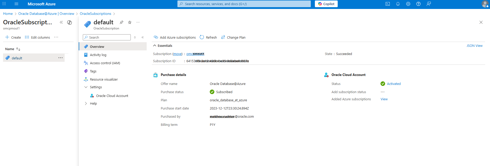

  3. Select default to view the details page for the Oracle AI Database@Azure offer that you subscribed to during service onboarding.
    Note
    On the details page for the default offer, the name of the primary Azure subscription for the Oracle AI Database@Azure service is shown in the Subscription field. The Subscription ID of the primary subscription is also shown.
    OracleSubscription Default View

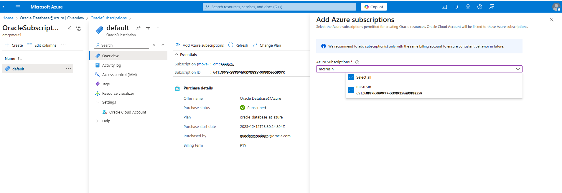

  4. Select Add Azure subscriptions.
    Add Azure Subscriptions
  5. In the Add Azure Subscriptions panel, select one or more subscriptions to add to your service using the Azure Subscriptions selector, then select Add.
  6. Optional. View the list of Azure subscriptions registered with the Oracle AI Database@Azure service. On the details page of the default offer, you can see active Azure subscriptions for the service under Oracle Cloud account. Select the View link beside Added Azure subscriptions to see the list of added subscriptions.
