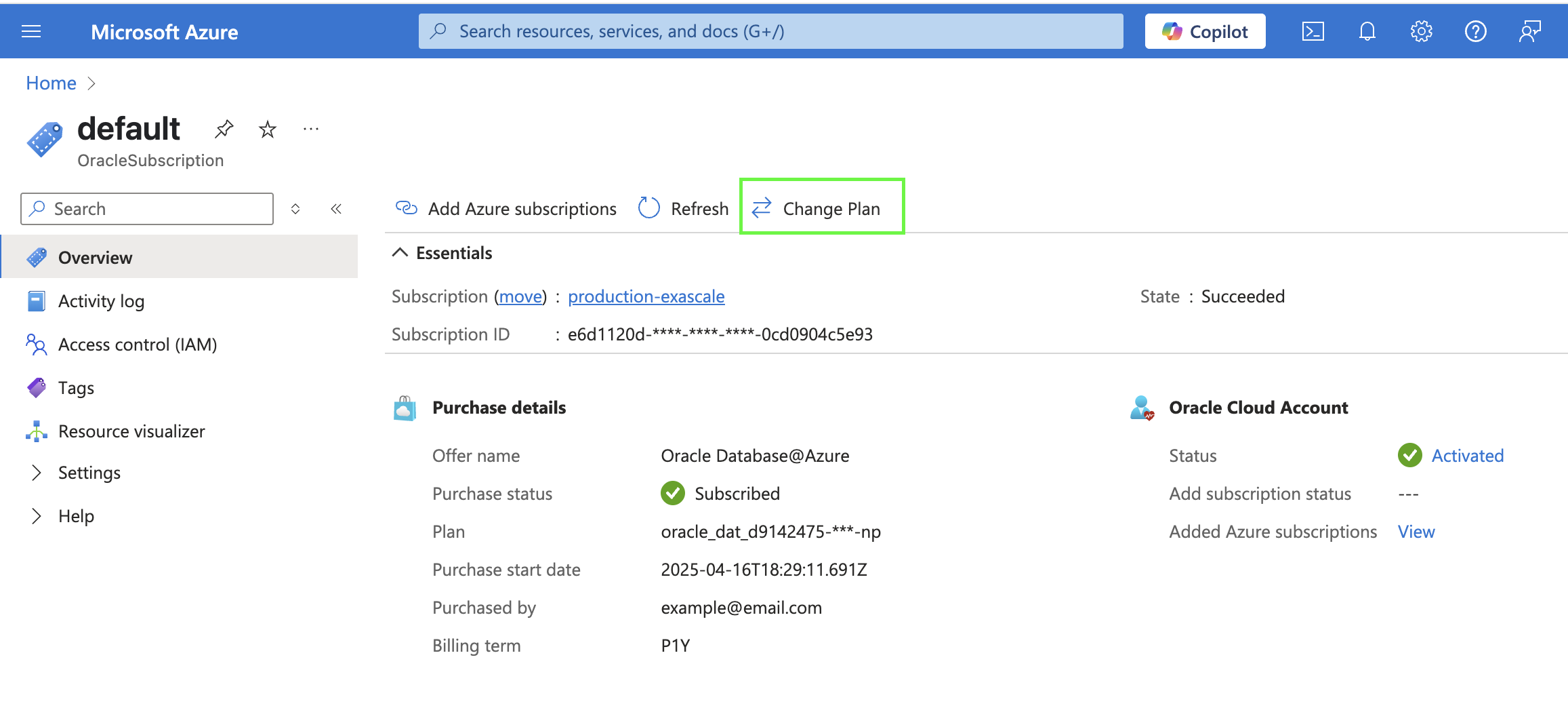

  4. On the OracleSubscription details page, select Change Plan.
    Change Plan on the OracleSubscription details page.

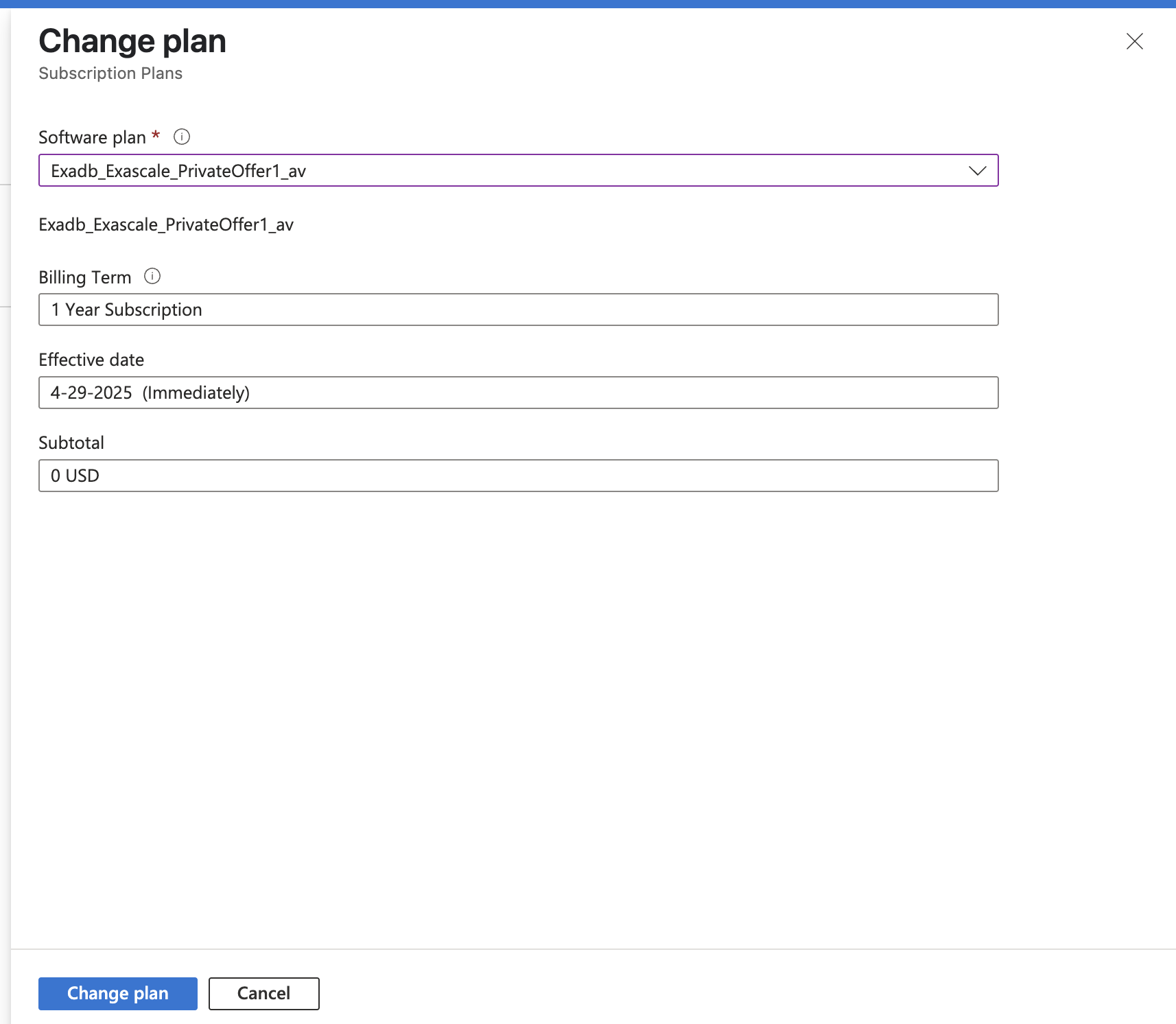

  5. In the Change Plan dialog, use the Software plan selector to select a new plan.
    Software plan selector in the Change Plan dialog.
  6. Review the details of the plan in the dialog, then select Change plan to continue.

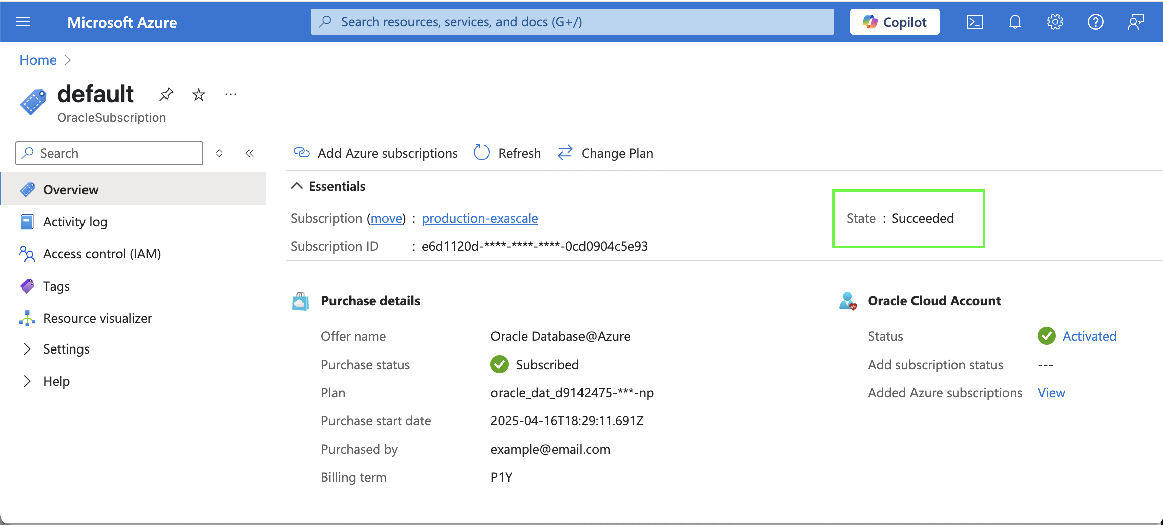

  8. When the plan is successfully changed, the State field displays "Succeeded."
    "Succeeded" state on the OracleSubscription resource details page.
