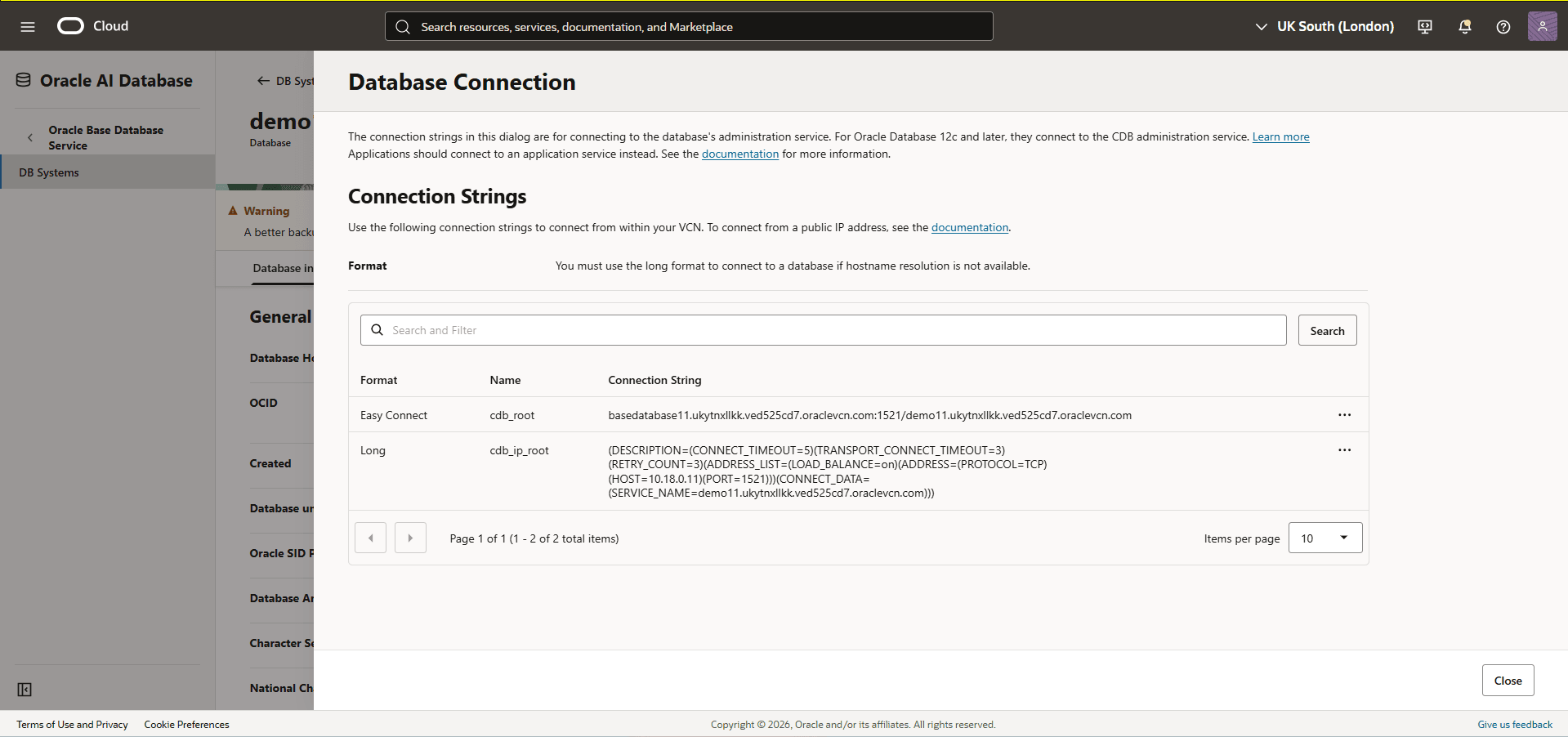

This screenshot shows the database connection.

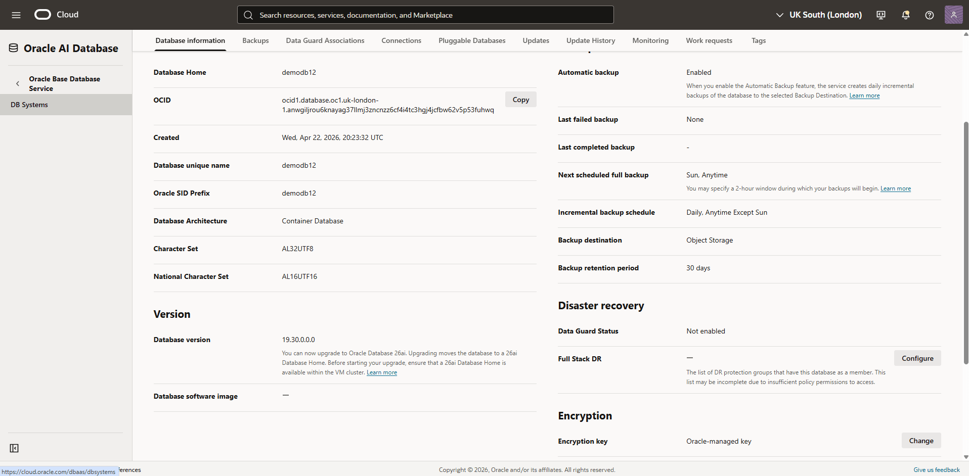

    View Encryption Details
    1. From the Oracle AI Database@Google Cloud console, select Base Database Service.
    2. From the left menu, select DB Systems, and then select the name of your Base Database.
    3. Select the Manage in OCI button, which redirects you to the OCI console.
    4. In the OCI console, select the Databases tab, and then select the database that you want to check the key management.
    5. From the Database information tab, navigate to the Encryption section to view the Encryption key details. By default, the Encryption key is set to Oracle-managed key. This screenshot shows key management information.

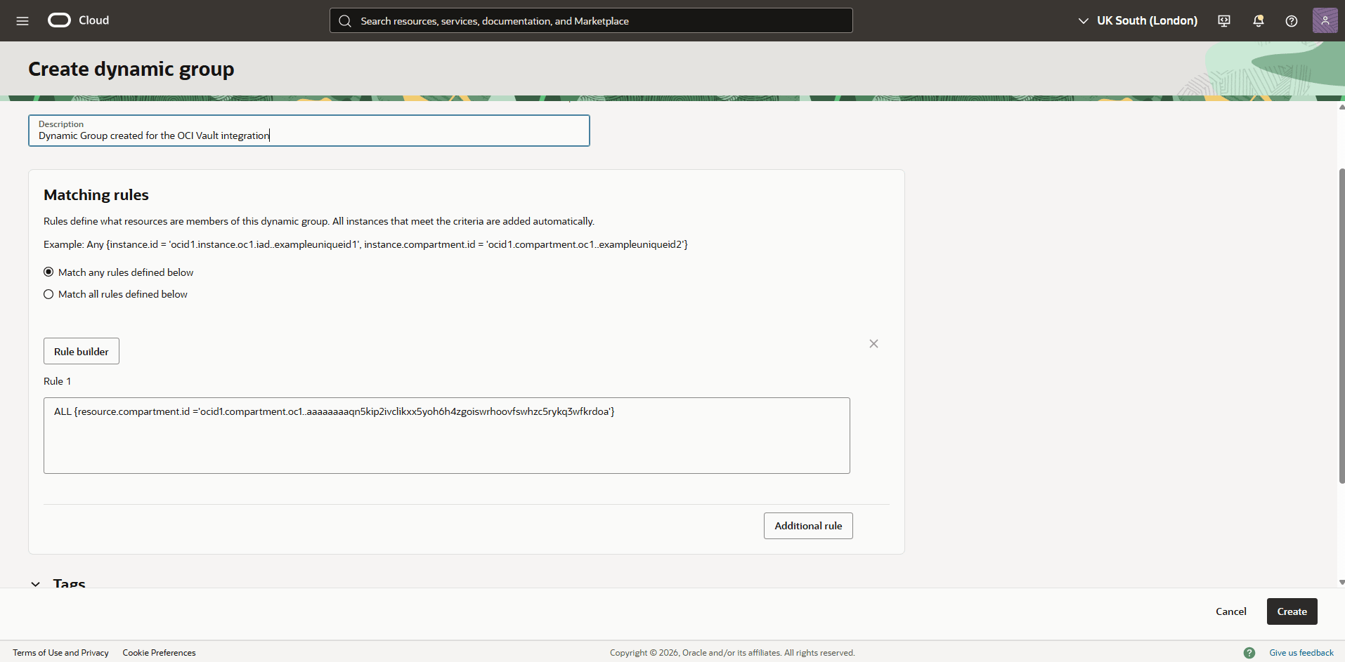

    3. Create an OCI Dynamic Group

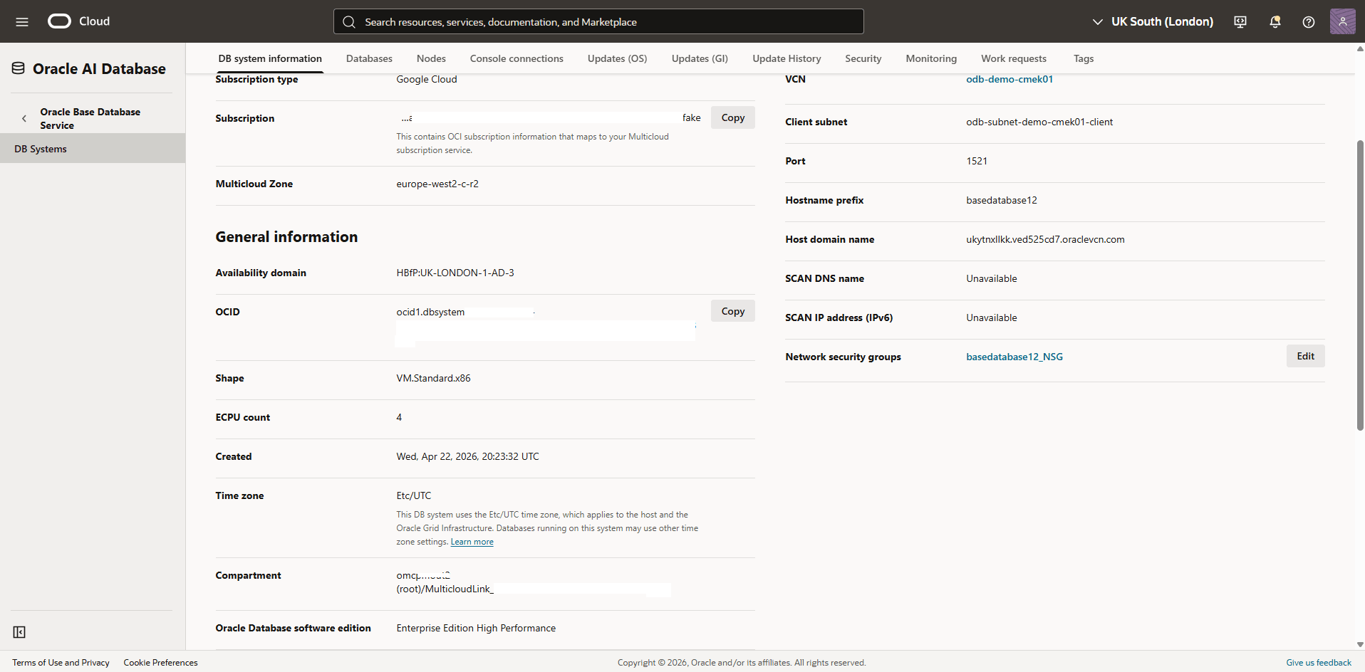

      1. From the OCI console, select Oracle AI Database, and then select Oracle Base Database Service.
      2. From the left menu, select DB Systems, and then select the name of the Base Database.
      3. Select the DB system information tab, scroll down to the General information section. Take note of your Base Database Compartment information. This screenshot shows how to obtain your compartment information.

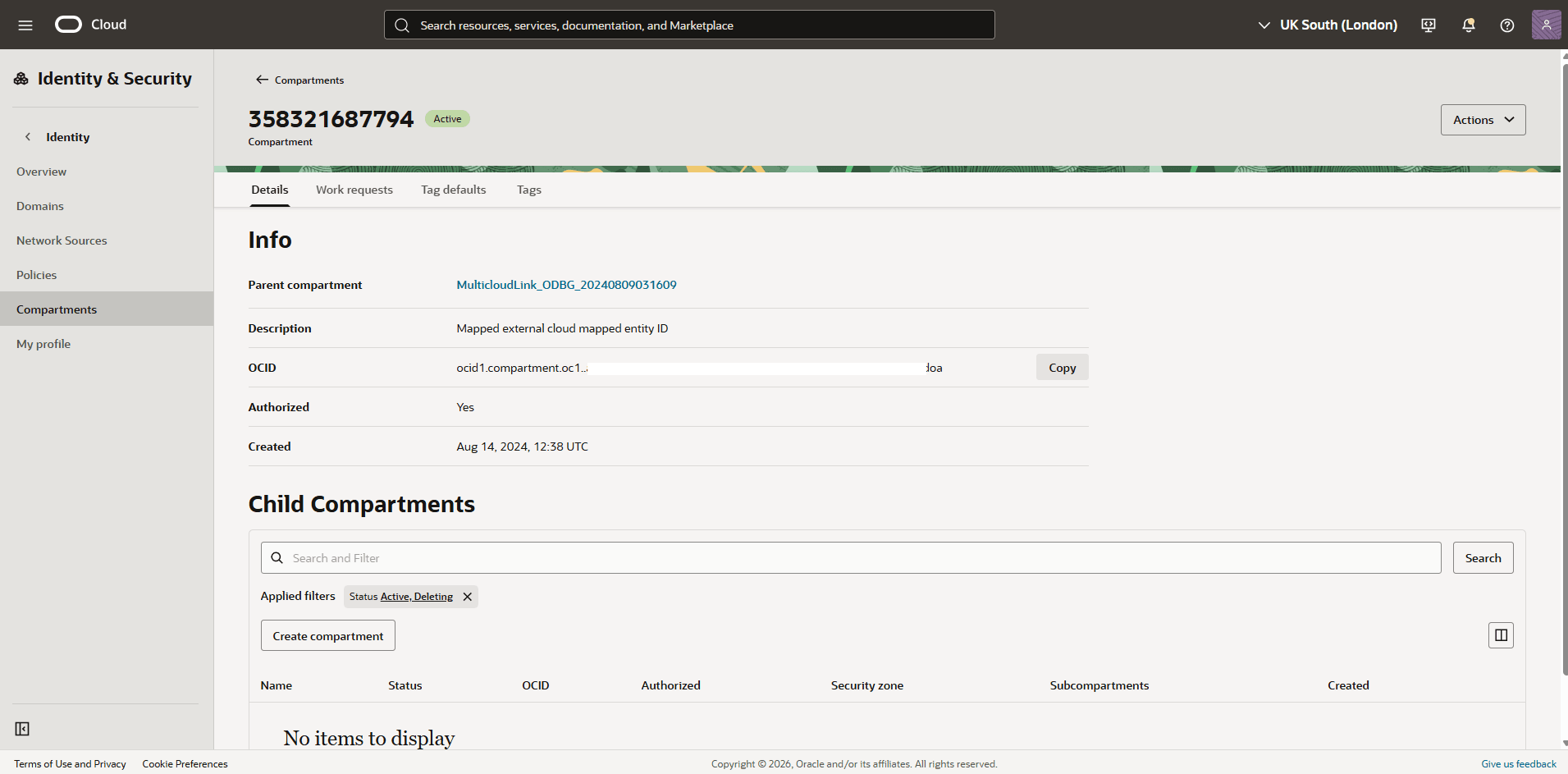

      4. From the navigation menu, select Identity & Security, and then select Compartments.
      5. From the Compartments list, navigate to your compartment which you previously created and copy the OCID information. This screenshot shows how to obtain your OCID information.

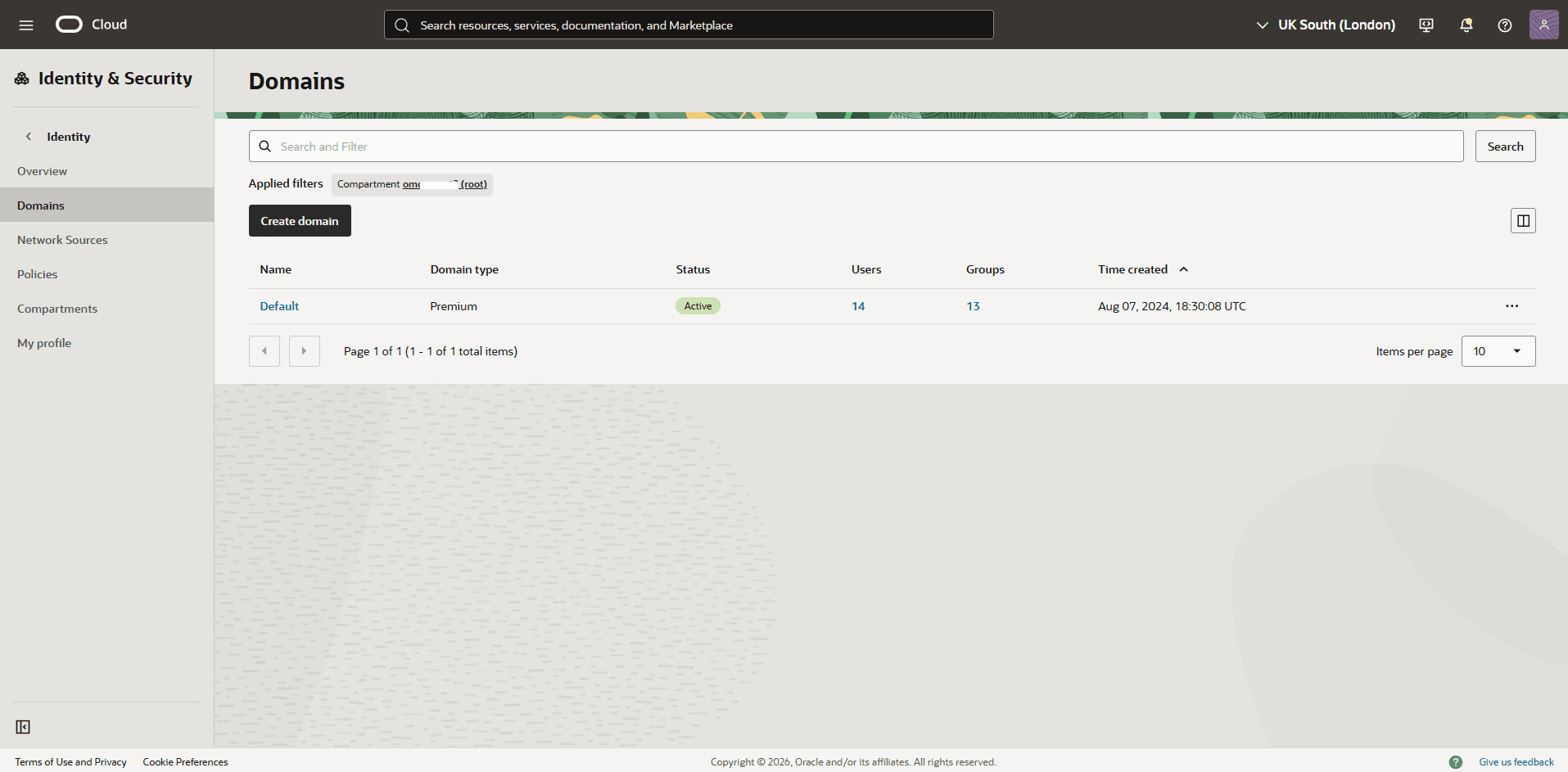

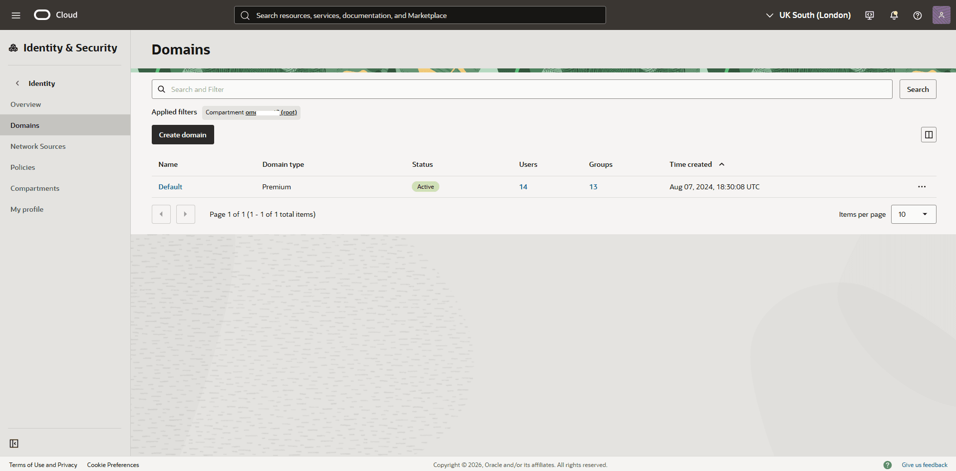

      6. From the navigation menu, select Identity & Security, and then select Domains.
      7. From the Applied filters section, select the Root Compartment and then choose the name of you domain. This screenshot shows how to navigate to your domain.
      8. Select the Dynamic groups tab, and then select the Create dynamic group button.
        1. Name: Enter a descriptive name for the group.
        2. Description: Provide a brief description of the dynamic group’s purpose.
        3. Matching Rules: Enter the following statement, replacing <your_Compartment_OCID> with the compartment OCID you noted in the previous step:
          ALL {resource.compartment.id = '<your_Compartment_OCID>'}
        4. Review your information, and then select the Create button.
        This screenshot shows how to create dynamic group.

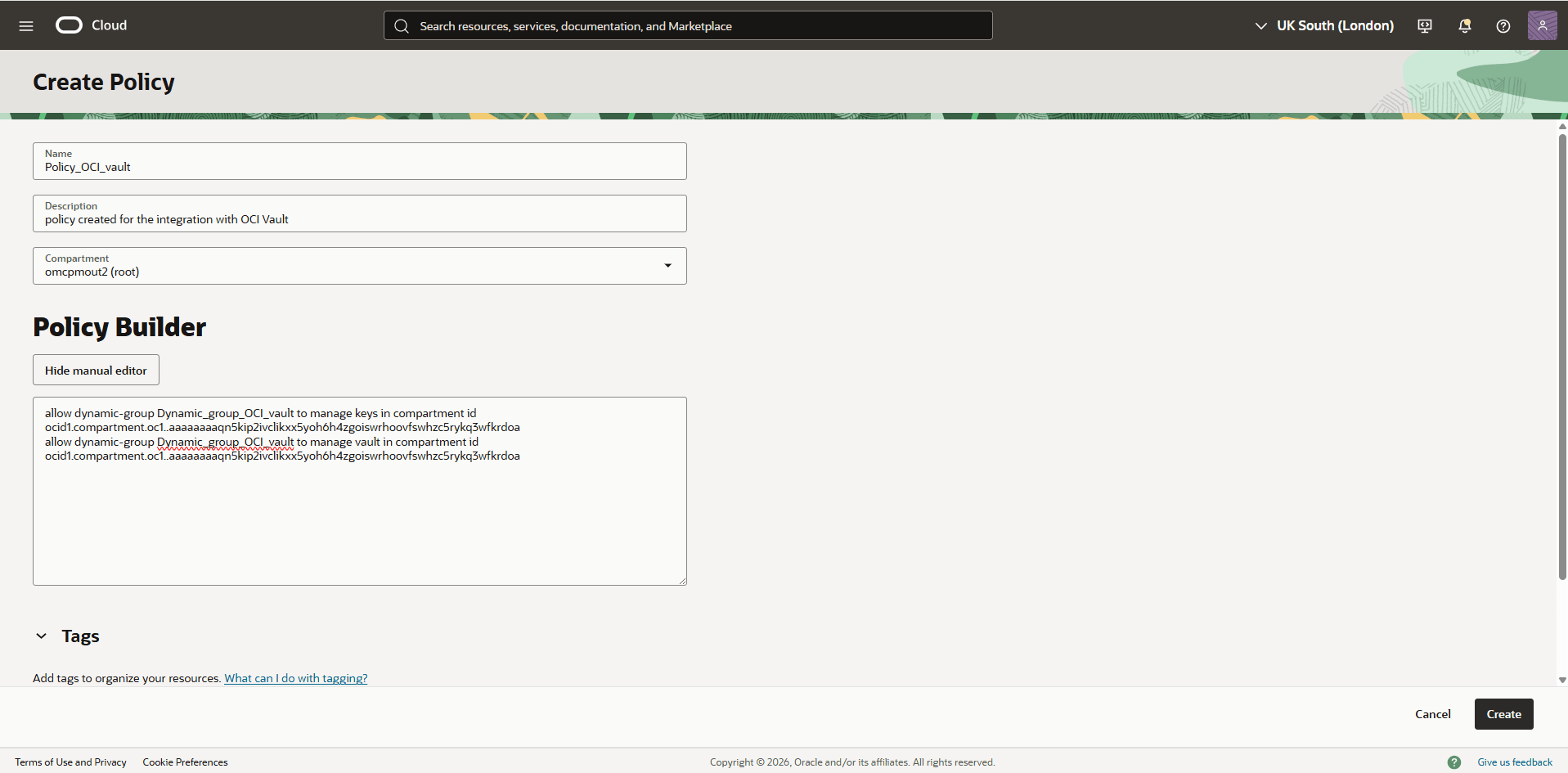

    4. Create an OCI Policy
      1. From the navigation menu, select Identity & Security, and then select Policies.
      2. In the Applied Filter section, select the Root Compartment, and then select the Create Policy button.
        3. Enable the Show manual editor button, and then enter the following statements. Replace <dynamic-group-name> with the name of the dynamic group created in the previous step, and<your_Compartment_OCID> with your specific compartment OCID:
          Allow dynamic-group <dynamic-group-name> to manage vaults in compartment id <your_Compartment_OCID>
          Allow dynamic-group <dynamic-group-name> to manage keys in compartment id <your_Compartment_OCID>
        4. Review your information and then select the Create button.
      This screenshot shows how to create a policy.

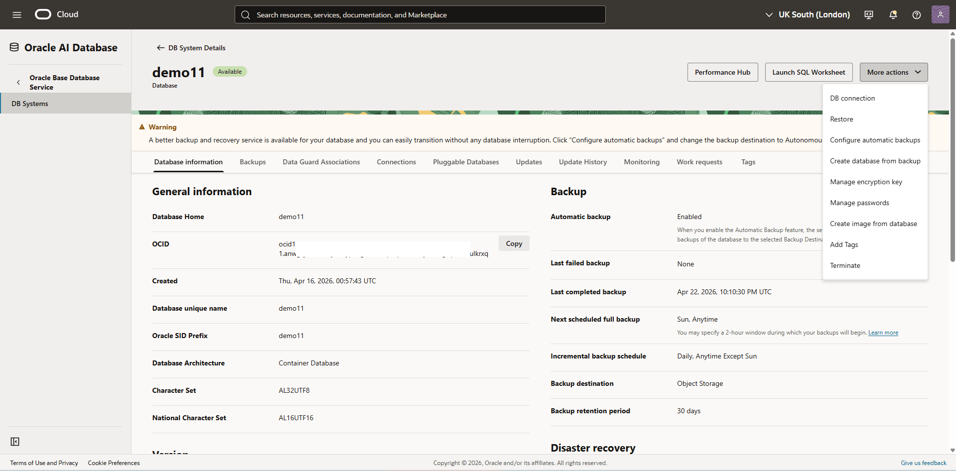

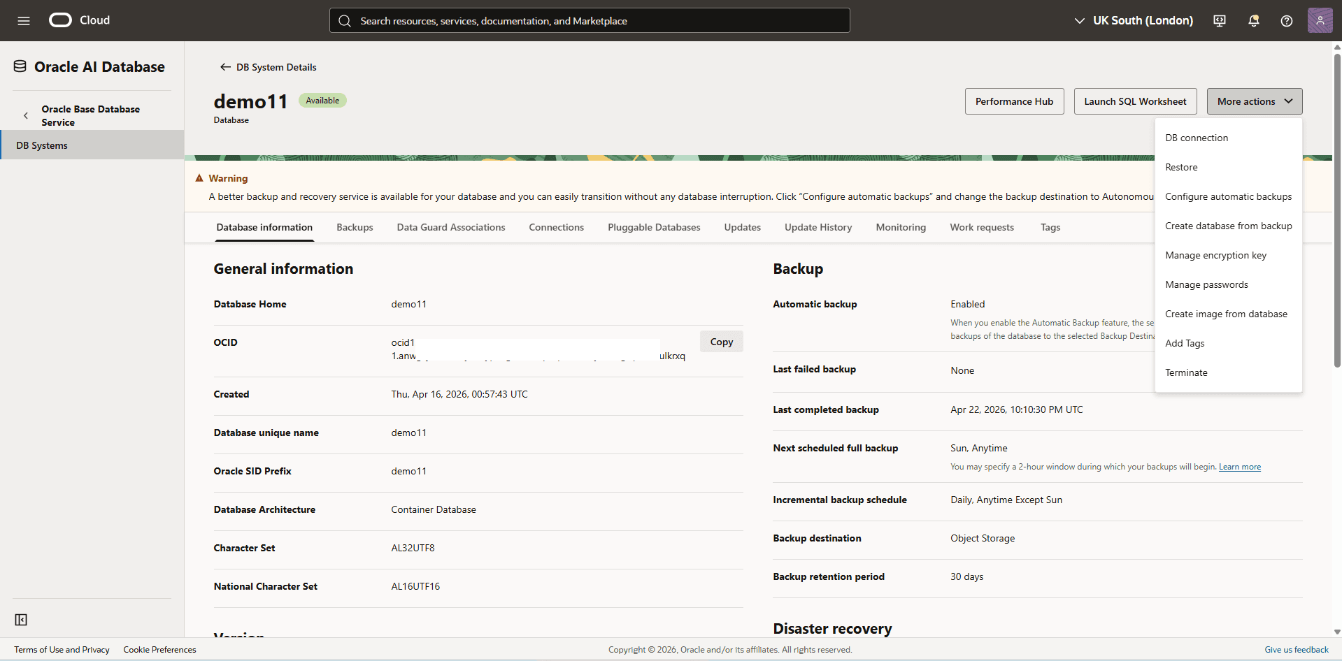

      3. From your Base Database system, navigate to Databases tab, and then select the name field of the database you wish to modify.
      4. Select the More actions button and then choose the Manage encryption key option. This screenshot shows how to create a policy.

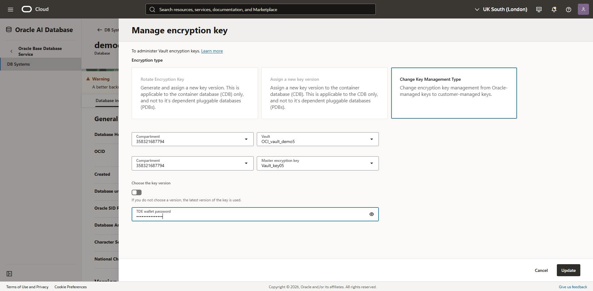

      5. From the Manage encryption key page, enter the following information.
        1. Choose the Oracle Key Management Type as Encryption type.
        2. Select the Compartment where you created your OCI Vault, and then select the OCI Vault from the Vault dropdown list.
        3. Select the Compartment where you created your OCI key, and then select the OCI key from the Master encryption key dropdown list.
        4. The Choose the key version toggle is optional. if you do not choose a version, the latest version of the key will be used.
        5. Enter your TDE wallet password.
        6. Select the Update button to save your changes.
        This screenshot shows how to change key management.

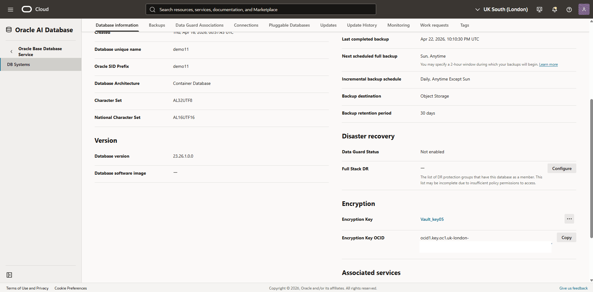

    7. Verify the Database Encryption Method
      3. Select the Databases tab, and then select the name of the database that you wish to validate.
      4. Scroll down to the Encryption section. In this section, you can view the Encryption Key and Encryption Key OCID details of the OCI key in use.
      This screenshot shows how to verify the database encryption method.

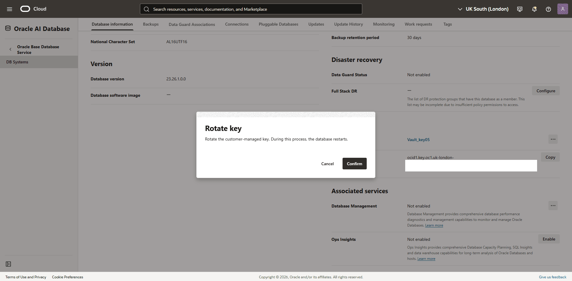

    Rotate the OCI Vault Key for a Container Database (CDB)
    3. Select the Databases tab, and then select the name of the database that you want to rotate encryption keys.
    4. Select the Action menu ( three dots) and then select the Rotate option.
    5. Select the Confirm button to save the changes. This screenshot shows how to rotate key.

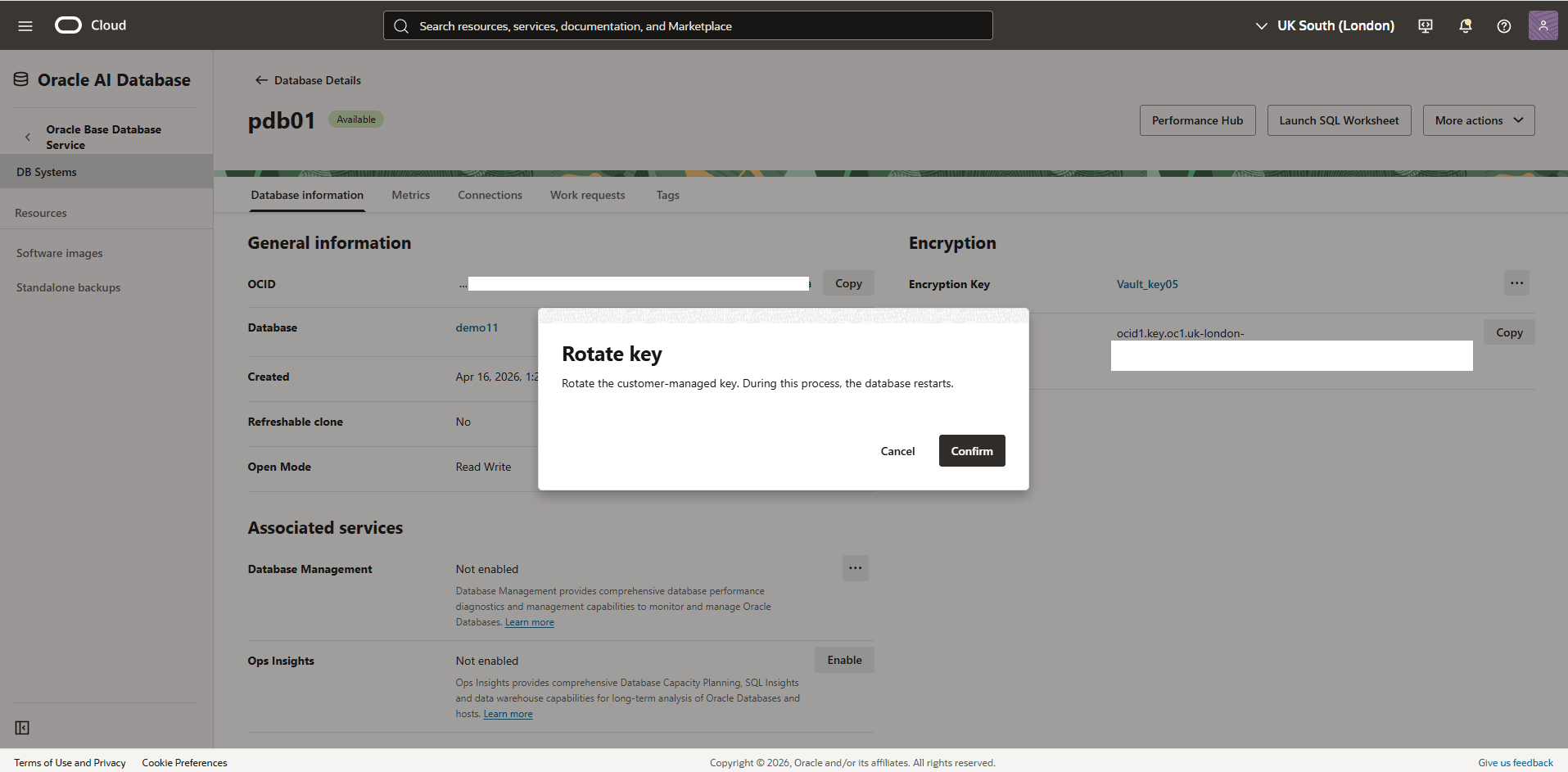

    Rotate the OCI Vault Key for a Pluggable Database (PDB)
    3. Select the Database tab and then select your database.
    4. Select the Pluggable Databases tab, and then select your Pluggable Database that you want to want to rotate encryption keys.
    5. The Encryption section displays the Encryption Key details.
    6. Select the Action menu ( three dots) and then select the Rotate option.
    7. Select the Confirm button to save the changes. This screenshot shows how to rotate key.
