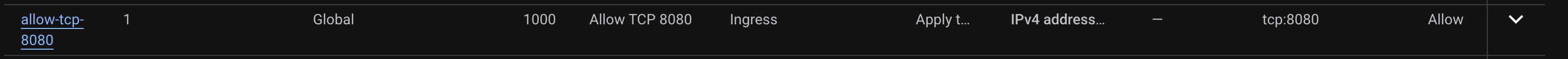

  • Ensure that port 8080 is open in your VPC firewall rules associated to VM Instance. This screenshot shows how to ensure the port is set to 8080.
  • Run the following command to enable Linux firewall port 8080.
    sudo firewall-cmd --zone=public --add-port=8080/tcp --permanent
    sudo firewall-cmd --reload
    sudo firewall-cmd --list-ports

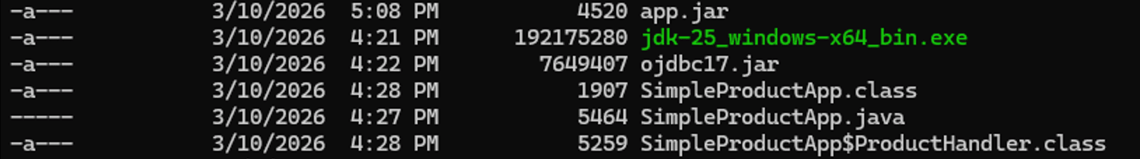

    5. After a successful compile and package, output directory will have additional files created as app.jar. This screenshot shows the directory files.

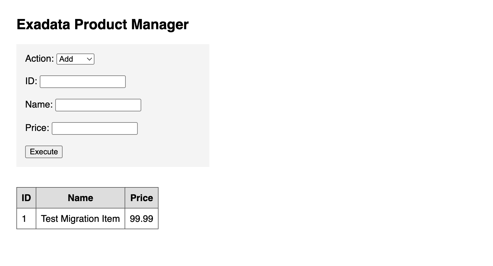

    4. To access the UI, open a web browser and navigate to http://<google-vm-public-ip>:8080.
    5. After the application starts successfully, the UI displays options to manage Products. This screenshot shows the UI to manage the Products.
