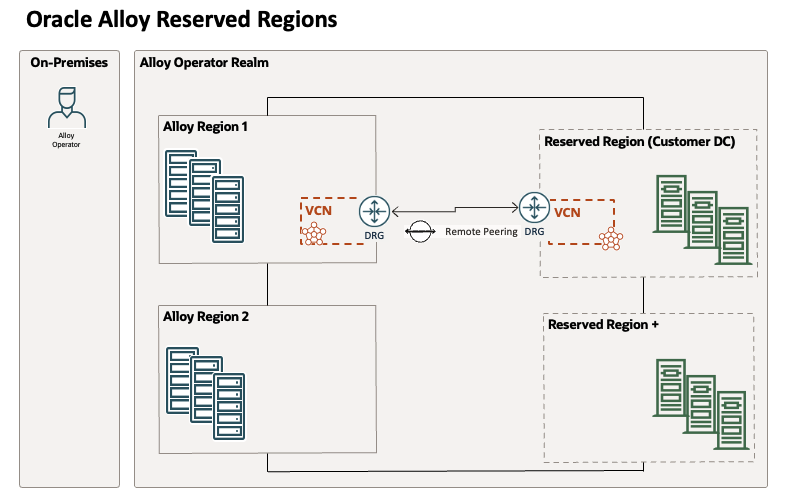

Oracle Alloy Reserved Region Diagram

Reserved Regions are hidden regions in an Oracle Alloy realm. they are intended for the exclusive use of one named end customer and that customer's wholly owned subsidiaries. This deployment pattern is based on the Dedicated Region25 (DR25) model with as few as 3 base racks and can be physically located in the end-customer data center when that architecture is selected.
A Reserved Region remains multitenant within that customer boundary, but it is not visible to other customers or to the operator's other customer-facing regions. Customers in other Oracle Alloy regions cannot discover or subscribe to the Reserved Region.
Disaster Recovery and Regional Relationships
Users in a Reserved Region can subscribe to the operator's other regions in the same realm to implement workload-level disaster recovery. This model preserves the operator's existing Oracle Alloy footprint as a recovery target while keeping the Reserved Region separate as the primary region.
If a workload requires a dedicated primary region and a dedicated secondary region, plan for a second Reserved Region or another explicitly designed failover architecture.

Networking follows the same architectural pattern for standard Alloy regions. This model includes mandatory internet transit for region operations, inter-region connectivity for cross-region recovery, FastConnect for remote customer connectivity, an out-of-band path for emergency access, and data center operator access for onsite support.
