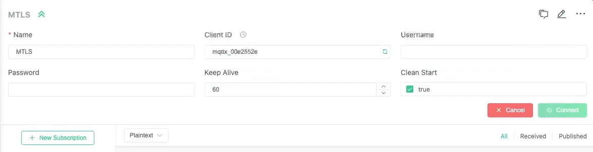

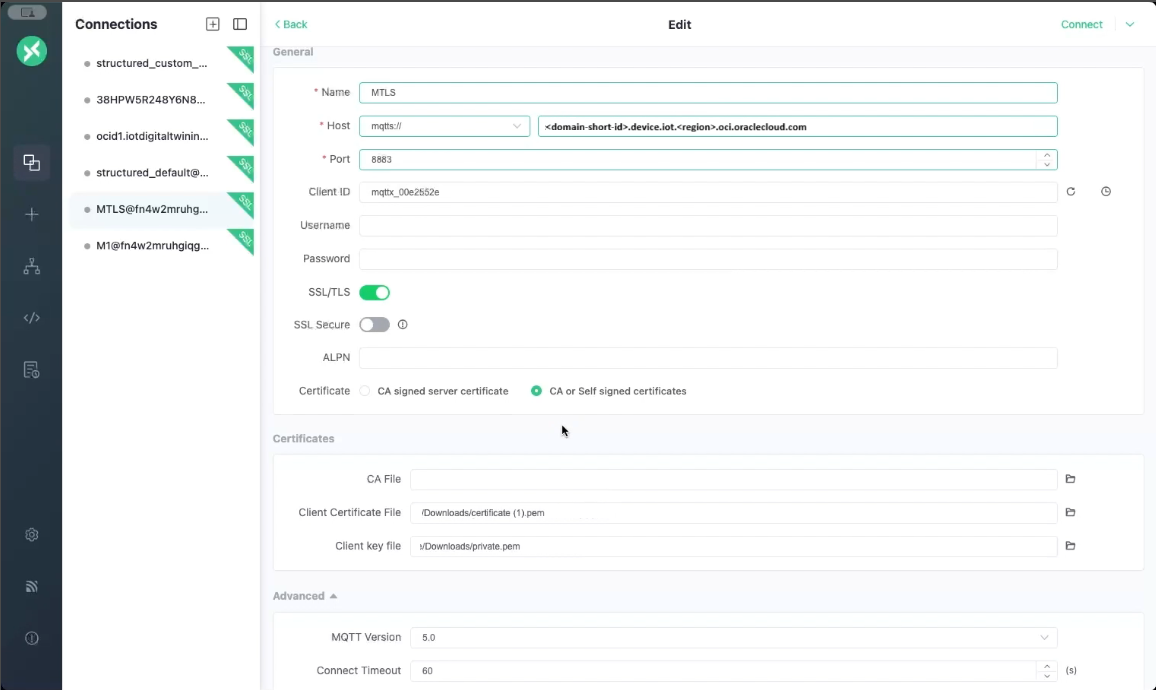

Use any MQTT client to subscribe to a topic using MQTTS. This example uses MQTTx.
To send sample data and test the connection:
- Enter the device host as the host, for example:
mqtts://<domain-short-id>.device.iot.<region>.oci.oraclecloud.com - Enter the port:
8883 - Client ID: your-client-id
- Clean Start: True
- Turn on the toggle to enable TLS.
- Select the option: CA or Self signed certificates
- Enter the client certificate file location, from step 15 in Create a Certificate that's Managed Externally:
your-certificate.pem - Enter the client key file location, from step 1 in Generate a New Private Key:
your-private-key.pem - Select Connect.

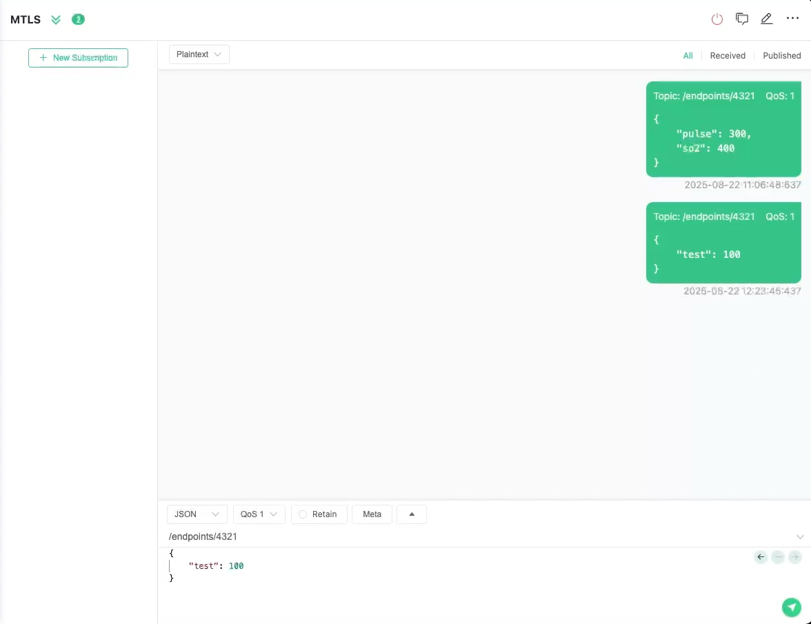

- Select New Subscription to receive data from a device.
- Enter the endpoint as the Topic.
- This example shows messages published to the
/endpoints/4321topic, at Quality of Service (QoS) level 1. topic:{ "pulse": 300, "s02": 400 }{ "test": 100 }
