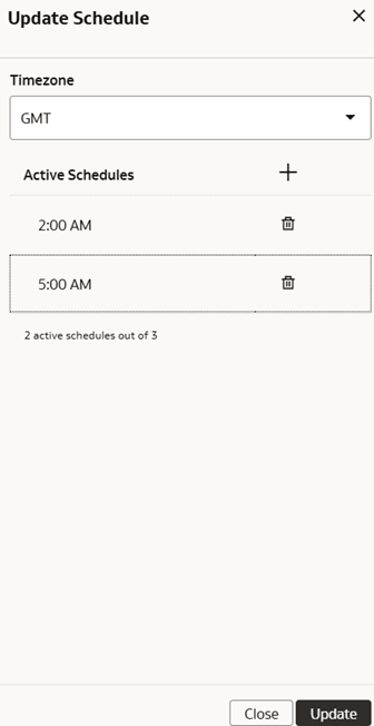

  4. In Update Schedule, specify these:
    1. Timezone: Select your time zone.
      Note
      While specifying the timezone, use city names to handle the daylight savings. For example, instead of selecting timezone such as EST or PST, select Europe/Bucharest or America/Los_Angeles. In this case, the data refresh process calculates the value mentioned in the Time field based on the local time irrespective of daylight savings. For additional details for Timezone, refer to TimeZoneID
    2. In Active Schedules, click the Add Schedule icon, enter a time, and click Update.
    Update Schedule dialog
