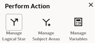

- On the Semantic Model Extensions page, under Customizations Sandbox, hover over an applicable sandbox to view Actions, and then click View Sandbox.
- On the selected sandbox Details page, click Perform
Action, and then select Manage Subject
Areas.
- In Perform Action, select Create a Subject Area, and
then click Next.
