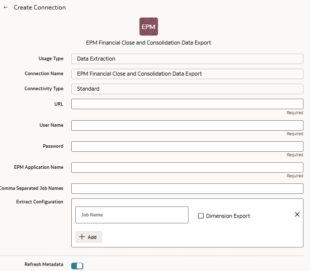

    4. In Create Connection, select Data Extraction in Usage Type and then select the connection type based on the functional module that you want to connect to. For example, to connect to the "Financial Close and Consolidation (FCCS)" module, select EPM Financial Close and Consolidation Data Export as the connection type.
      EPM Financial Close and Consolidation Data Export connection option
    5. In Create Connection for the EPM source, enter these details and click Save:
      • URL: Enter the specific URL of your EPM source ensuring to use https. For example, https://epm7-test-a123456.epm.us6.oraclecloud.com. If you provide http://epm7-test-a123456.epm.us6.oraclecloud.com or epm7-test-a123456.epm.us6.oraclecloud.com, then the system rejects it.
      • User Name and Password: Enter the credentials for your EPM source. Prefix the user name with the domain of your EPM source, such as domain.username.
      • EPM Application Name: Specify the file name that you had entered in Download File Name while creating the EPM data exchange job in EPM.
      • Comma Separated Job Names: Provide the EPM data exchange job names. If you’ve multiple job names, then ensure that they are comma separated. For example, FAWEPMTestingV2, FAWEXPORT,FAW Job Testing.
      • Extract Configuration: Provide the EPM data exchange job name in Job Name and select Dimension Export if you want to extract the hierarchy (dimensional data) from your EPM Export Data instance.
      EPM Financial Close and Consolidation Data Export Create Connection dialog
