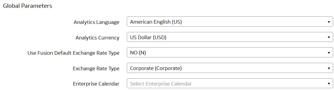

  6. Under Global Parameters, provide these details:
    1. From the Analytics Language list, select the language in which you want to extract the data.
    2. From the Analytics Currency list, select the currency of the transaction data.
    3. In Use Fusion Default Exchange Rate Type, specify whether you want to use the default exchange rate type from Oracle Fusion Cloud Applications.
    4. From the Exchange Rate Type list, select an exchange rate type that you want to use when converting the transaction amounts to the global currency.
    5. From the Enterprise Calendar, select a fiscal calendar to configure the reporting calendar used in Oracle Fusion Data Intelligence.
    Global parameters on the Pipeline Settings page

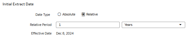

  7. In Initial Extract Date, select Absolute or Relative as Date Type and provide these details:
    • If you select Absolute, provide the date from which to load the transaction data.
    • If you select Relative, provide the period in Relative Period and select either Days, Weeks, Months, or Years.
      Note
      The system displays the "Effective Date”. The effective date indicates how far back the data is available in the warehouse. The warehouse may have data beyond the relative period. In the next application update, the system deletes this older data.
      Relative initial extract date details
