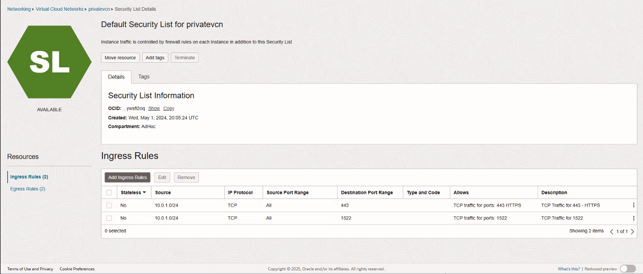

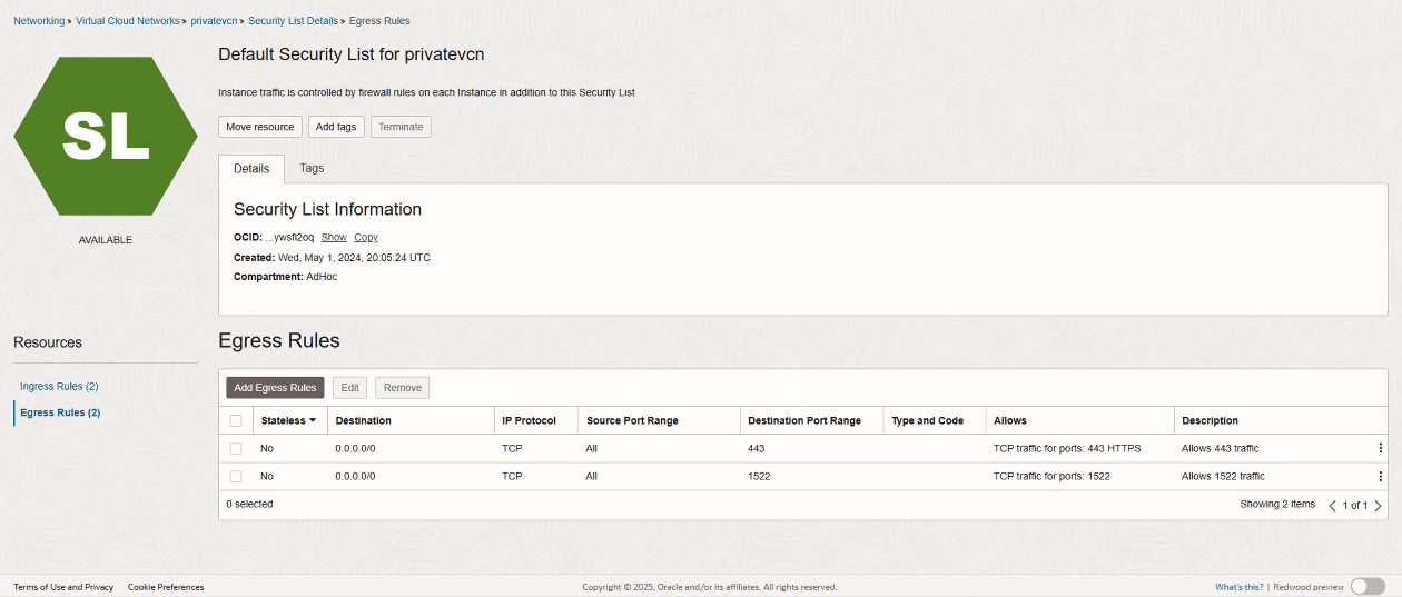

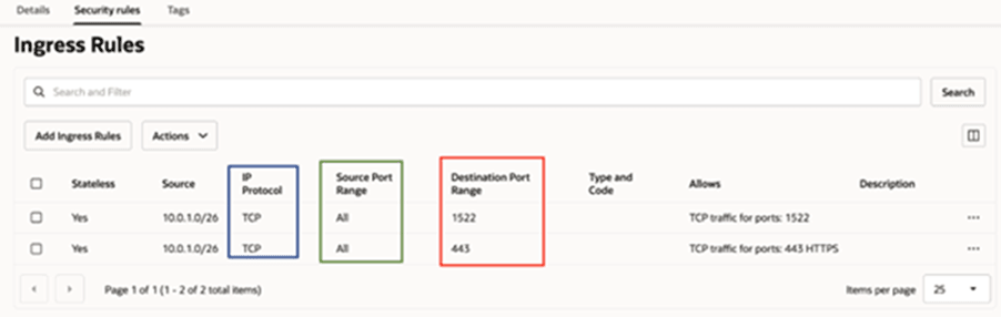

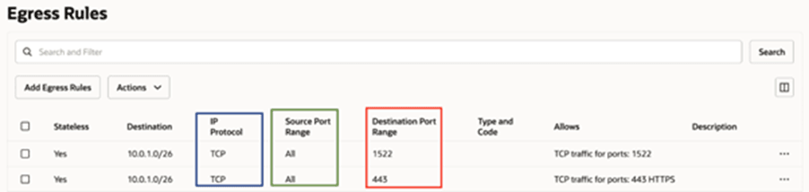

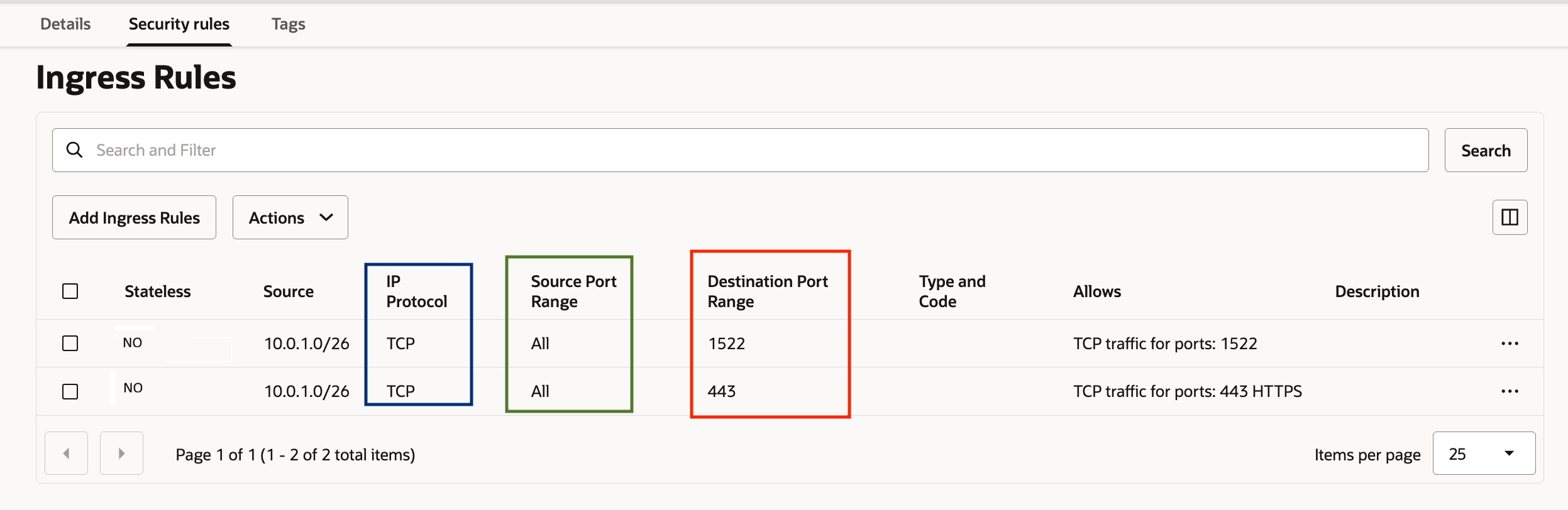

  2. Set up security rules. You must configure Stateful Rules for ingress and egress. See Stateful Compared to Stateless Rules.
    When configuring security rules, ensure the following:
    • Source CIDR: Must be either 0.0.0.0/0, <VCN CIDR>, or <SUBNET CIDR>.
    • IP Protocol: TCP or All Protocols.
    • Source Port Range: ALL
    • Destination Port Range: Either ALL, or specifically 1522 and 443.
    Note
    You specify inbound and outbound traffic on Port 1522 for Oracle Autonomous AI Lakehouse and Port 443 for Oracle Analytics Cloud while entering the security rule information for the network security group or VCN. Ensure that the VCN/SUBNET CIDR block allows ingress and egress in the rules to ports 443 and 1522. The functioning of an Oracle Fusion Data Intelligence instance with a private endpoint requires both these ports.
    Description of fawag-ingress-rules-pvt-fdi_oak.png follows
    Description of fawag_egress_rules_pvt_fdi.png follows

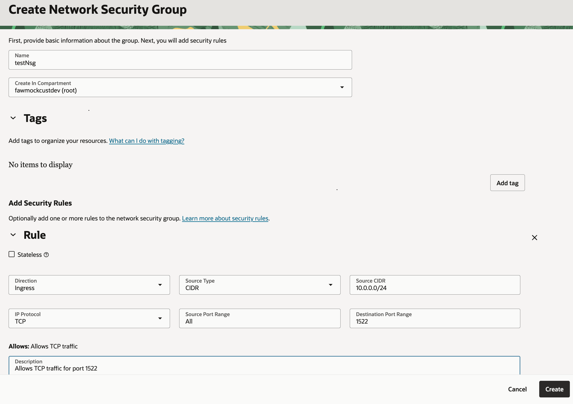

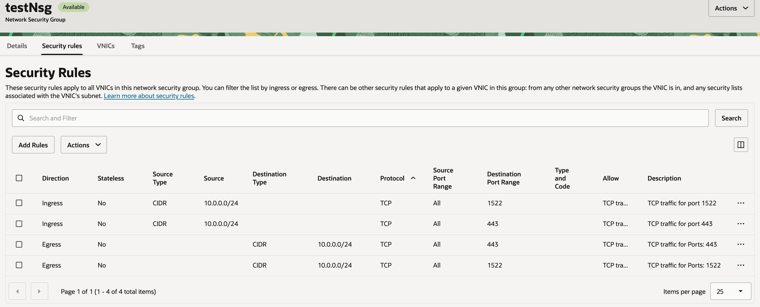

  3. If you plan to restrict traffic (ingress and egress) using network security group rules, then you must do so when you create your Oracle Fusion Data Intelligence instance. You can specify up to 5 network security groups to meet your business requirements. Ensure that the network security groups exist in the same VCN as your Oracle Fusion Data Intelligence.
