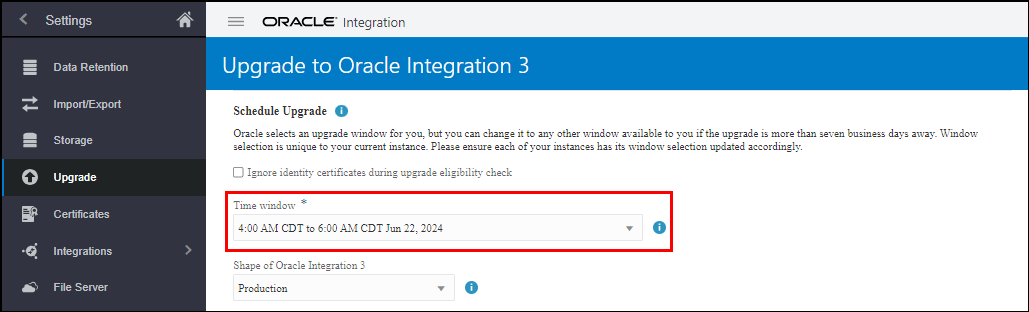

| Time window |
If your upgrade has been scheduled, you see your upgrade window. You can change your upgrade window if it's three or more business days away, as described above.

| Shape of Oracle Integration 3 |
The shape determines when the instance receives updates. The shape you select determines the upgrade time windows that are available.
You can't change the shape after the instance has been assigned an ingress or egress IP address. If the shape is not correct and you're unable to change it, submit a service request (SR) on My Oracle Support.
Note
You can't change the shape after the upgrade is complete. However, you can move data to another instance using the export and import features.
