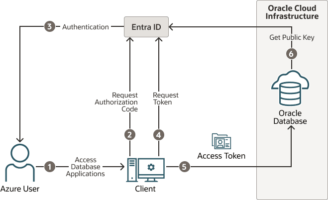

The following diagram is a generalized flow diagram for OAuth 2.0 standard, using the OAuth2 token. See Authentication flow support in MSAL in the Microsoft Entra ID documentation for more details about each supported flow.
Description of image follows
The authorization code flow is an OAuth2 standard and is described in detail as part of the standards. There are two steps in the flow. The first step authenticates the user and retrieves the authorization code. The second step uses the authorization code to get the database access token.
  1. The Azure user requests access to the resource, the Oracle AI Database instance.
  2. The database client or application requests an authorization code from Entra ID.
  3. Entra ID authenticates the Azure user and returns the authorization code.
  4. The helper tool or application uses the authorization code with Entra ID to exchange it for the OAuth2 token.
  5. The database client sends the OAuth2 access token to the Oracle AI Database. The token includes the database app roles the user was assigned to in the Entra ID app registration for the database.
  6. The Oracle AI Database instance uses the Entra ID public key to verify that the access token was created by Entra ID.
