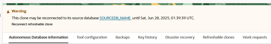

On the disconnected instance the Autonomous AI Database details page displays a banner indicating the date and time up to which you can reconnect the database to the source. The banner also includes a Reconnect refreshable clone link. For example:
See Reconnect a Refreshable Clone to the Source Database for more information.
