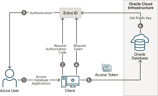

The following diagram is a generalized flow diagram for OAuth 2.0 standard, using the OAuth2 token. See Authentication flow support in MSAL in the Microsoft Entra ID documentation for more details about each supported flow.
Description of azure-authentication.eps follows
The authorization code flow is an OAuth2 standard and is described in detail as part of the standards. There are two steps in the flow. The first step authenticates the user and retrieves the authorization code. The second step uses the authorization code to get the database access token.
  1. The Azure user requests access to the resource, the Oracle Database instance.
  2. The database client or application requests an authorization code from Entra ID.
  3. Entra ID authenticates the Azure user and returns the authorization code.
  4. The helper tool or application uses the authorization code with Entra ID to exchange it for the OAuth2 token.
  5. The database client sends the OAuth2 access token to the Oracle database. The token includes the database app roles the user was assigned to in the Entra ID app registration for the database.
  6. The Oracle Database instance uses the Entra ID public key to verify that the access token was created by Entra ID.
Both the database client and the database server must be registered with the app registrations feature in the Azure Active Directory section of the Azure portal. The database client must be registered with Entra ID app registration. Permission must also be granted to allow the database client to get an access token for the database.

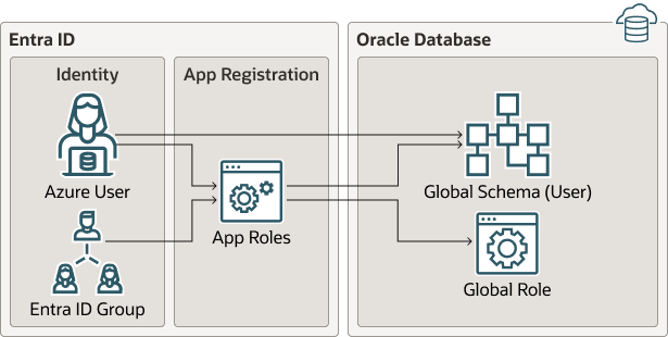

Azure Users Mapping to an Oracle Database Schema and Roles
Microsoft Azure users must be mapped to an Oracle Database schema and have the necessary privileges (through roles) before being able to authenticate to the Oracle Database instance.
In Microsoft Azure, an Entra ID administrator can assign users, groups, and applications to the database app roles.
Exclusively mapping an Entra ID user to a database schema requires the database administrator to create and manage a database schema for the lifecycle of the user (joining, moving, leaving). The database administrator must create the schema when the user joins the organization. The database administrator must also modify the privileges and roles that are granted to the database schema to align them with the tasks the Azure user is assigned to. When the Azure user leaves the organization, the database administrator must drop the database schema so that an unused account is not left on the database. Using the database app roles enables the Entra ID administrator to control access and roles by assigning users to app roles that are mapped to global schemas and global roles. This way, user access to the database is managed by Entra ID administrators and database administrators do not need to create, manage, and drop schemas for every user.
An Azure user can be mapped to a database schema (user) either exclusively or through an app role.
  • Creating an exclusive mapping between an Azure user and an Oracle Database schema. In this type of mapping, the database schema must be created for the Azure user. Database privileges and roles that are needed by the Azure user must be granted to the database schema. The database schema not only must be created when the Azure user is authorized to the database, but the granted privileges and roles must be modified as the Entra ID roles and tasks change. Finally, the database schema must be dropped when the Azure user leaves the organization.
  • Creating a shared mapping between an Entra ID app role and an Oracle Database schema. This type of mapping, which is more common than exclusive mappings, is for Azure users who have been assigned directly to the app role or is a member of an Entra ID group that is assigned to the app role. The app role is mapped to an Oracle Database schema (shared schema mapping). Shared schema mapping allows multiple Azure users to share the same Oracle Database schema so a new database schema is not required to be created every time a new user joins the organization. This operational efficiency allows database administrators to focus on database application maintenance, performance, and tuning tasks instead of configuring new users, updating privileges and roles, and removing accounts.
In addition to database roles and privileges being granted directly to the mapped global schema, additional roles and privileges can be granted through mapped global roles. Different Azure users mapped to the same shared global schema may need different privileges and roles. Azure app roles can be mapped to Oracle Database global roles. Azure users who are assigned to the app role or are a member of an Entra ID group that is assigned to the app role will be granted the Oracle Database global role when they access the database.
The following diagram illustrates the different types of assignments and mappings that are available.
Description of azure_mappings.eps follows
These mappings are as follows:
  • An Azure user can be mapped directly to an Oracle Database global schema (user).
  • An Azure user, Entra ID group, or application is assigned to an app role, which is then mapped to either an Oracle Database global schema (user) or a global role.
