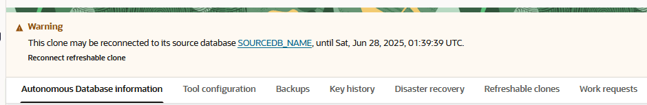

  • On the disconnected instance the Autonomous AI Database details page displays a banner indicating the date and time up to which you can reconnect the database to the source. The banner also includes a Reconnect refreshable clone link. For example:
    Description of adb_refreshable_clone_reconnect.png follows
    See Reconnect a Refreshable Clone to the Source Database for more information.
