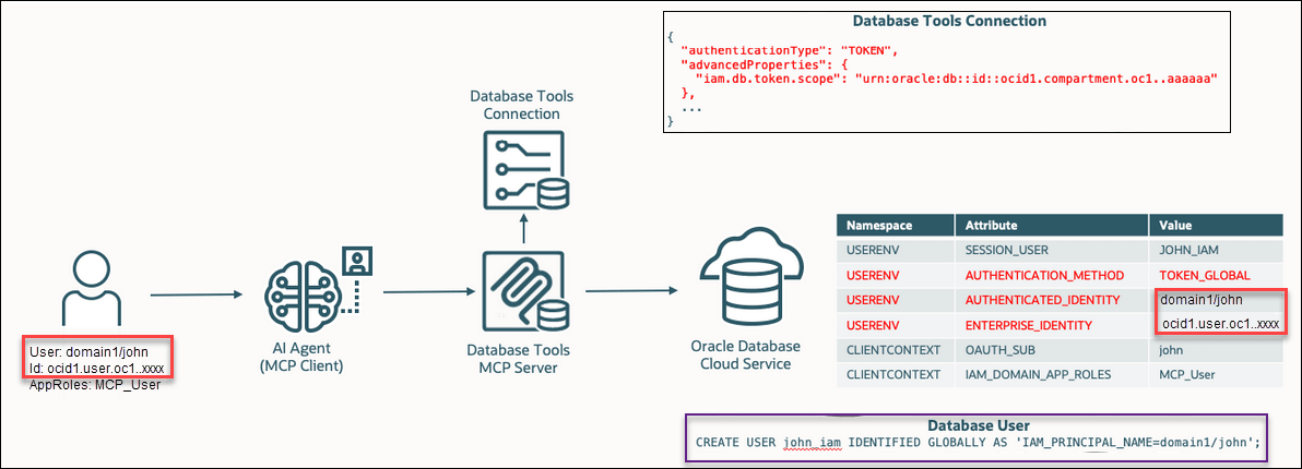

The following diagram depicts an end-to-end flow where a user with IAM application roles uses an MCP client to call the Database Tools MCP Server, which connects to Oracle Database Cloud Service using a Database Tools Connection configured for token-based IAM database authentication.
The diagram also shows how the user’s IAM identity is propagated to the database. It also highlights the database-side setup for IAM users, that is, creating a database user identified globally by an IAM principal name.
The following steps describe how a user request is authenticated, authorized, and executed from the MCP client to the database through the MCP Server.
  1. The user signs in using IAM SSO and the MCP client obtains an access token.
  2. The client calls the MCP Server with Authorization: Bearer <token>.
  3. The MCP Server validates the token and the user’s roles.
  4. The MCP Server obtains the required time-bound database authorization.
  5. The MCP Server executes the request and returns results.
