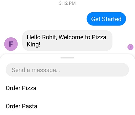

Persistent Menu
Facebook Messenger enables you to create a persistent menu next to its Message field. See https://developers.facebook.com/docs/messenger-platform/send-messages/persistent-menu/ for details on the feature.
Here's an example that shows persistent menu items for "Order Pizza" and "Order Pasta":
